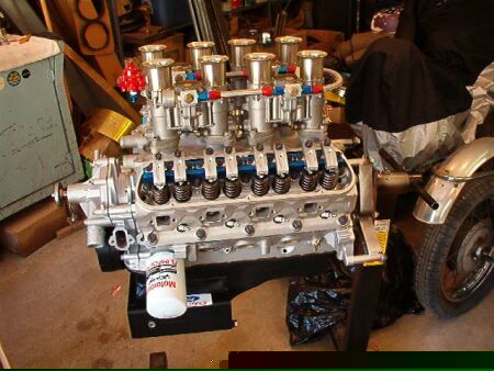

O.K., Chris where are those Gurney-Westlake Valve Covers? I toiled long today to get where the engine is as you see it.
Valves are adjusted, manifold trial fit and also the special small Dist. Cap to make sure I have clearance. I have a few odds and ends, but nothing major.

Gee that looks good! Its doing 6500prm standing still!! The induction setup is right on the money.

Well here is another look. This time with Webers, they are just a good looking to my eye as the Injection. Came into the house from the shop this morning and heard on the answering machine my car made port and is waiting to go thry customs. Yahooooooo
