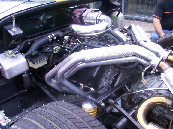

Ford 4.6 liter in a GT40
Some have asked whether a 4.6L will fit in a GT40.
Here's a DRB with a 4.6L engine installed.
The primary tubes look like they'll be a bit close to the rear clip. /ubbthreads/images/graemlins/shocked.gif

Is that the power steering reservoir I see in the picture?
Does this car have PS or is the pump used for some other purpose?
Inquiring (OK, simple) minds want to know!
Rick /ubbthreads/images/graemlins/confused.gif
