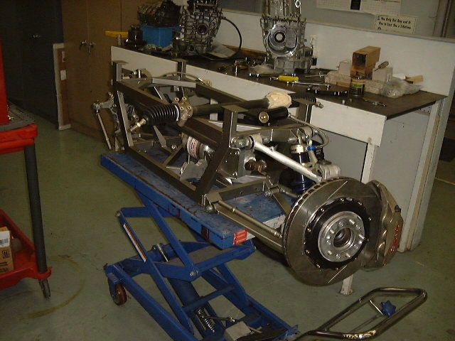

The Mosler website mentions/discusses/shows many gearboxes. They mention Hewland (for racing), clearly show Porsche gearboxes and sell parts plus show pictures of Quaiffe's.
One of the pictures looks like a 993 or 996 gearbox running inverted (upside down and backwards).

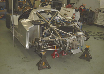

Here is another with a couple of Porsche transaxles apart on the workbench in the background.

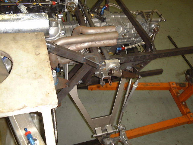

And the last, here is what is stated to be a recent chassis with what I recognize as one of the new Quaiffe 6-speed gearboxes (they also sell parts for these gearboxes on the Mosler website).
As for gearbox length, I recall them being within an inch or two of each other (993 vs 996). Reading from the Mosler website, their original bad*ss midengine V8 cars used 4-speed Porsche gearboxes (those would have to be 911 turbo/930).
