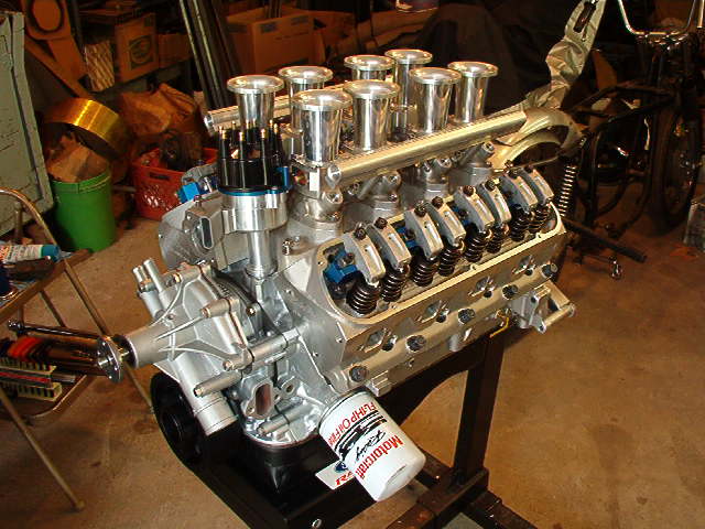

Here is aq pic of my engine with the Edelbrock heads
Vic

Victor,
What a gorgeous engine!!

Victor, that IS a great looking motor you built. Is that an aluminum block 302 Ford? How much power does that make, and what does it weigh?

Hi Jim, No the block is not Aluminum! I wanted the engine not to be multi-colored. I always paint my oil pans semi or flat black as I believe the heat is transfered to the air better. Thus I didn't want a Blue Block, black pan and Alum for the rest of the engine. The paint is Dupli-Color High Temp Alum over hand brushed Rustoleom with a Hi-Temp Clear. The block was deburred and smoothed inside and out.
The block is a new roller explorer unit filled with the best parts I could find, Boss 302 steel crank, H-beam rods,Hipertech pistons and a Comp cam.
Similar engines I have built make about 400 to 420 HP with a Speed Demon carb. I am anxious to put this one on the Chassis Dyno soon after I get the bugs worked out so I can see if the Fuel Injection was worth the cost and the installation.
