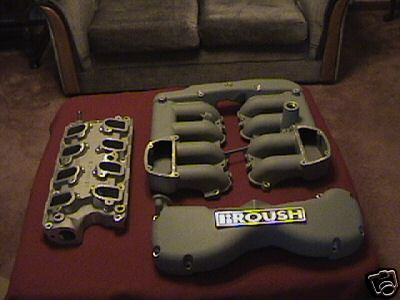

I haven't been able to take measurements yet, but I think I now have to solution for the problem of getting enough air into a high RPM Dart based engine. I have just purchased a Rousch '94/'95 Cobra intake. Here are some pictures

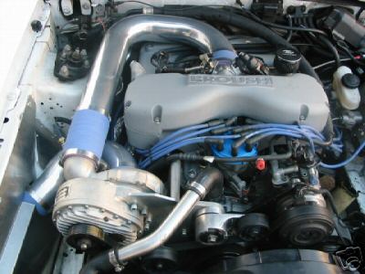

Here is a picture of one on a 91 Mustang:

I have been trying to find some specs on this intake as have a lot of the guys in the Roush world. The only thing anyone has been able to find in terms of performance expectations is the following from the Roush '94/'95 marketing slick. BTW, this intake system was the Stage III add-on for '94-'95 Rousch cars.
"Of particular interest is the Roush Induction system - 65mm throttle body, high flow air filter, three-piece Roush dual plenum intake assembly. They claimed it added 47HP to your stock 5.0! With GT-40 heads, up to 99HP, and with Roush CNC-ported GT-40 heads, up to a 120HP gain!"
