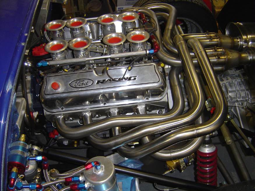

This will fit.
A 302 SVO stroked to 331ci

OMG, that's awesome.
Guys, I'm made up. Thanks for the advice and such a warm welcome to the BB. It's certainly not going to be my last post. I'll try to make the next club meeting, new job/house move/wife allowing.
