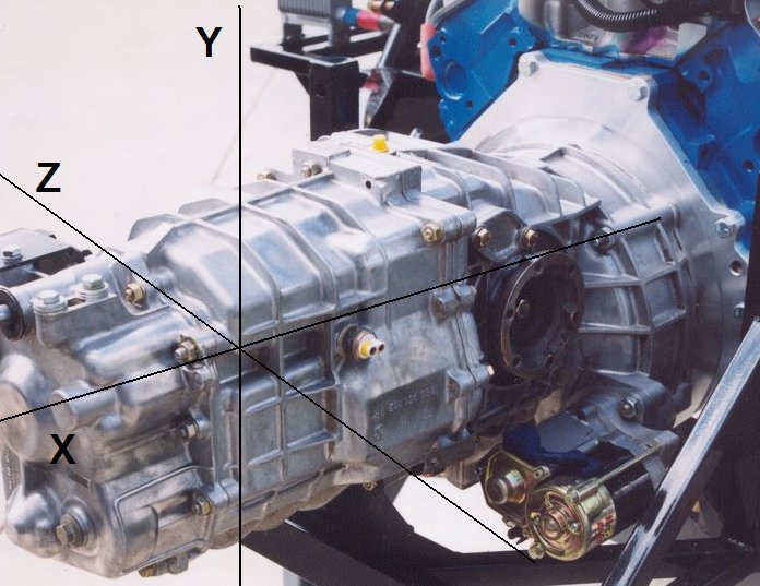

Now I am confused. We flip the transaxle upside down (inverted) and this would give a Porsche with the engine in the rear 5 reverse and 1 forard gear. Then we rotate it 180° around the Y axis so that the engine is in front of the axle (wrt the car), so now it once again has 5 forward and 1 reverse. As I sit in my chair whirling my fingers, hoping the neighboors aren't watching as I spin my chair around and then turn upside down, it dawns on me that the direction the internals of the transaxle have not changed direction through out this exercise. I suppose I was thinking along the lines of the Corvair where the engine does indeed turn the other way round and when used in the midengine position the gears are indeed turning opposite of their normal direction. There are other cases where the engine rotates in the opposite direction of the engine in a normally rear engined car and then the new setup is used as a midengine drive train. So the Ford V8 and the Porsche 911 engines must rotate in the same direction, since my car goes in the right direction :-)
Anyone who is less spatially challanged than I am want to comment?

The G50 is reversed (180 deg) and flipped (180 deg),
hence five forward and one reverse gear. Think about it's
orientation in a Porsche, then "do the math".
Fatal Attraction is offline

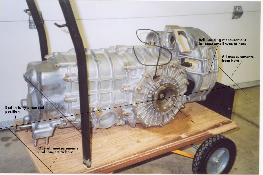

Des,
Here are the measurement I took off of a G50/50 ('89 911 Turbo)
    [*]Overall length with shifter extended to its max 28 5/16" [*]Overall to max of case (includes cones for shafts)26 3/4" [*]Front to flat surface of nose cover 25 1/2 " [*]Front to Diff/gerbox case split 14" [*]Front to gearbox/nose piece split 22 14" [*]Front to CV Flange Center 8 5/8"[*]Front to rear of Bell Housing 3 3/8"[*]Nose piece overall (as above w/ shifter) 6 1/16" [*]Nose piece overall (as above w/ cones) 4 1/2" [*]Nose piece overall (as above to flat) 3 1/4" [/list]
llarsen is offline
Old 10-28-04, 11:20 AM   #33 (permalink)
aladinsane's Avatar
aladinsane
Join Date: Mar 2004
Location: So Cal, USA
GT40: Tornado
Posts: 746
Re: Porsche transmission oil coolers
[ QUOTE ]
[/ QUOTE ]
Lynn,
Hate to "beat a dead horse" but I now am sitting hear doing the rotating chair and finger exercise to only to get a head rush and confuse myself [img]/ubbthreads/images/graemlins/crazy.gif[/img]
Question is: when “inverting” the G50, i.e. the trans case now upside down and in the mid-engine position, is it then necessary to flop the ring & pinion to the other side?
In this question “inverting” defined as simply flipping the tranny from rear-engine to mid-engine configuration with the output shaft\cv’s above the input shaft instead of below. Leaving the internals untouched.
In my pathetic mind, even though the trans is upside down the input shaft remains turning clockwise whether standard or inverted wherein axle rotation remains the same, no internal changes necessary.
Tim
aladinsane is offline
Old 10-28-04, 11:46 AM   #34 (permalink)
llarsen's Avatar
llarsen
Join Date: Jun 2003
Location: Raleigh, NC
GT40: Sabre
Posts: 2,073
LOL, and I can since I have been there and done that. Here is my G50 mounted to the SBF. I have overlain an X, Y and Z axis to give us a frame of reference. So this is in the inverted position and has 5 speeds forward and 1 speed in reverse. Now lets take it back to its "normal" Porsche position. First lets flip it 180º about the X axis. It still in mid engine position, but we have just made it run with 5 speeds in reverse and 1 speed foward, right? Do the twirly finger thing :-). Now if we flip it 180º about the Y axis, it is sitting in the normal Porsch position and again has 5 spds forward and 1 in reverse. Now if we had left it in the second position,it would have been upright with respect to the way it runs in a Porsche, with the input shaft above the half shafts, BUT to make it have 5 speeds the right way, we could flip the ring gear in the diff to accomplish in another way than flipping the whole box.
Does this help?
Lynn
llarsen is offline
Old 10-28-04, 11:53 AM   #35 (permalink)
aladinsane's Avatar
aladinsane
Join Date: Mar 2004
GT40: Tornado
Posts: 746
Lynn,
Thank you, I can stop spinning now [img]/ubbthreads/images/graemlins/grin.gif[/img]
A picture is a 1000 words [img]/ubbthreads/images/graemlins/wink.gif[/img]
