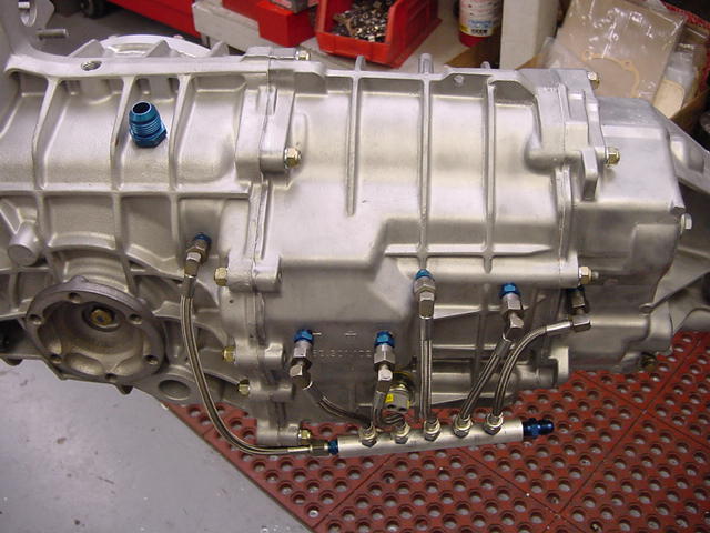

Recieved some pic, no price yet

another

again

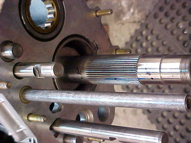

old setup

The picture of "the old setup" looks a lot like Rick Merz's unit in his GTD.

Lynn, that is the same pump that I am using. The old set up is very similar to mine except that the oil fittings are drilled into the top of the my transmission case not the side. I think that I paid about $150 for my pump but then that was a few years ago.

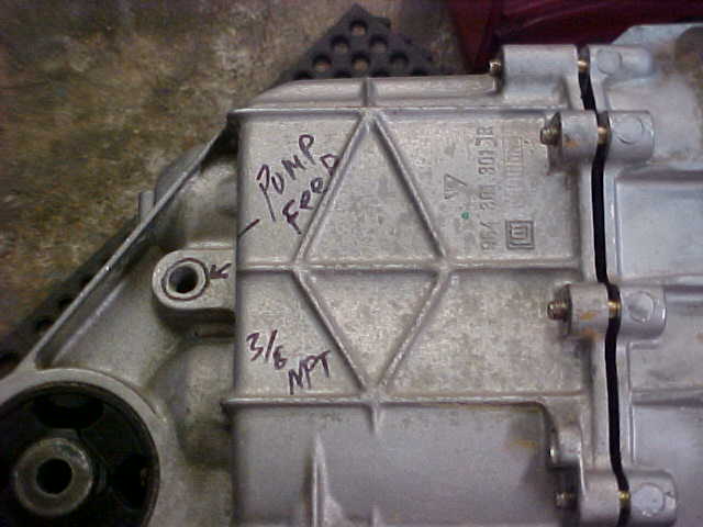

However, looking at the old style photos you supplied and the photos that Rick Mertz supplied I am wondering if your pump supply location couldn't be used for my return and to direct the return towards the R&P? I don't think you can really see where that boss enters the diff cavity in the pic above and Rick doesn't use it the boss for his return. His line enters below the boss, nearer the midline of the diff section. I guess the main reason I am interested in using the boss is that it is there to provide an entry to the inards. I don’t think I will be able to wrap a sprayer around the pinion gear like the new set up does; that is really nice.
As far as the pump supply point goes, I am torn between using the location shown in the old setup above or just using the port that was the vent on the midline. Using the midline location would certainly give the fitting more meat to engage with. The other location is more protected be being nestled down between the two ribs. The bell housing makes either location fairly well protected though. I can’t really tell from Rick’s photos exactly where his supply line is coming from. I like the way he has the pump tucked down in there beside the trannie. Hey Rick, are both sets of coils in the back for the transaxle or is the one on the driver’s side for engine oil? They both look like the same Mocal heat exchanger I am using for engine oil; it is located in the airstream from the driver’s side door scoop.

Sorry Lynn, i am a little confused but i think it is because i didnt tell you everything. My tranny is upside down, going in my 40. Those pics are of a 4wd with a hollow shaft, thats what you see sqirting out onto the pinion, should have said ignore that part. In the new system photo up top, the 3/8 npt is pressure feed to the spray bar, you need to drill in and meet a hole on the insode (which needs to me milled out to 1/2 "). For the return, look at the old system photo, the AN fitting sitting on top is actually the bottom, that is the return PHII said to use. If you do decide to do the external setup.the first 2 cases are easy to get off, then everything is attached to the bellhousing still, it gets ugly afterr that but is not too crazy. It would be worth it to pull those 2 cases i think, or grease the hell out of your drill and taps, use a vaccuum, do it all upside down, and cross your fingers.

OK, I got you Eric. I understand the 3/8 NPT port and this will not be useable to me at all. And I re-read the Word doc where you said the boss was used for non-inverted applicaions and since I thought this depicted the setup you were using, I assumed yours was non-inverted. So you will not be using the boss for the sump line taking the oil to the pump either: and this line is what you are referring to as the return line, right? The big blue AN fitting is used to take oil to the pump. Did PHII say why they wouldn't use the former vent for this? I wonder if they figure you need a drain anyway, so use it for that.

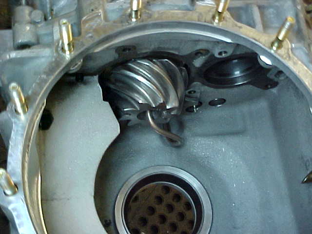

Back to the boss on the side of the diff. What does it look like on the inside? Do you think it would be possible to put a pressure line through it with some sort of tubing bent to put the oil on the R&P? Is the view from the point on the inside of the diff housing adjacent to the boss, open to the R&P? See what I am thinking? The default setup will be a line from big blue AN fitting to the cooler coil-> to the pump -> back to tranny via tubing aimed at the R&P.

Ok, had a look at my tranny which is all in peices. If all you plan to do is shoot the diff with oil, that boss points basically right at the ring and pinion mesh point allmost pefectly. If, again, you are just doing the ring and pinion, then it is very simple to pop the side cover off and drop the diff out of the thing,, do your drilling and then re-assemble. The whole internal spraybar setup however, is nice because it will lube every single gear, for some reason, even the reverse idler gets a shot, as well as the ring and pinion. It is just a bit more work to do. If you are feeling very lucky, you could just take the first 2 covers off, use a die ginder, magnets, vacuum and some rags to keep the shaving away, grind out the center plate and install the tube that way. The only other part that needs any work is the end cover, and it is off.
As for the suction line to the pump, not sure why they said to use the place in the pic above, i just figured, like you, that it became the drain instead.
