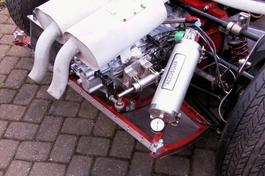

We use a 3qt unit on Roys GTD - hopefully no longer required as car is now dry sumped but may still be retained as a pre-oiler to lubricate on start up.

Hello Paul !!
I'm not trying to hijack this post, But I have a question. Is that a linear actuator for the shifter, mounted left of the accusump ?? If so, can you provide any contact information on the product.
Thanks for your time !!!!!
Brian

Re: Accusump Capacity
Brian - you have email+pics [img]/ubbthreads/images/graemlins/smile.gif[/img]
