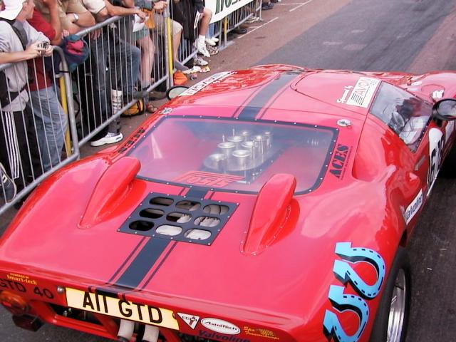

I too very much like the look and sound of webers however there are problems. (IMHO) Both Roy and I have seen examples of premature early bore wear - which we have put down to bore wash from over fuelling at idle. Driven, i'm sure they are fine but if an engine is left to idle too long, i think they are less than ideal. Also - starting is generally more problematic compared to injection. Roy's GTD starts and idles, from hot or cold, better than it ever did on conventional carburation.
Sorry to hear your friend has had problems with the Motec system Ron - it may not be the cheapest but it still is one of the most popular for higher performance installations over here and once configured, remains reliable over many years.
8 x 54mm Kinsler / Motec - hmmmmm (just don't forget the ear plugs!)
