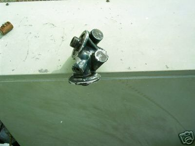

There is one on ebay; it's not mine and I don't know what the condition is. Here is the url:
http://cgi.ebay.com/ebaymotors/ws/eB...category=46098

The remote adapter is plan B at this stage. I have it in mind but I think an adapter like the one Mistral gave us a picture of is the sort of thing I was talking about. If anyone knows of any more of this type, I would be pleased to hear from you. As most of you are aware, space is of a premium in these engine bays so the smaller the better.
The oil cooler Bill has is meant to go forward so the angle on the adapter is about 90 degrees. Unfortunately my alternator is in the way. If it is oriented down the oil cooler and filter hits the sump. I know this because I have already got one, so sorry Bill but no sale this time.
