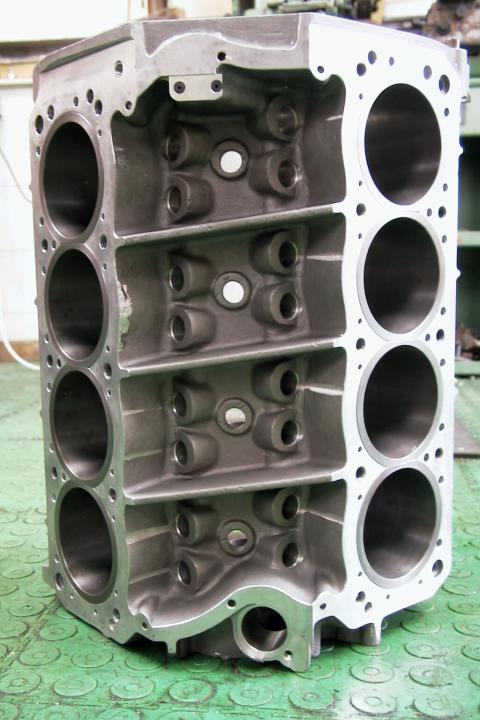

Here's a couple of pics of Roy's Fontana 302 - as supplied, which was the basis of his 347.

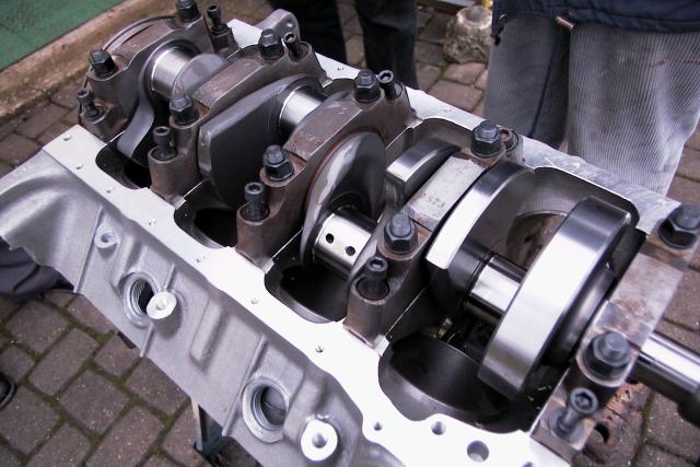

and from below - with stroked crank. Again, these pictures were taken before the internals were extensively reworked to 'get it all to fit' -

Please have that motor weighed if possible before it goes in the car and note the configuration during weighing (carb or not, water pump or not, etc.) I would love to know the total weight of an all alumimium 347. This would represent the lightest of engine weights based on the Ford V8, and my aluminium head cast iron block (465 lbs) would be more toward the upper end. I would guess 325 lbs. I expect about 100 lbs going from cast iron block to aluminium and ~40 lbs going to the shorter deck height. Thanks.

I think it is too late for that Gary, that motor has been raced extensively in the car unless it has been out for freshening.

As Ron said, engine has been used for several seasons now, although I did speak to Roy and checking records - he seems to think the block was about 90lbs. I remember that I could carry it 'one armed' but that doesnt tell me very much!
Engine has just gone back in after Winter refresh/upgrade and dry-sump installation.
