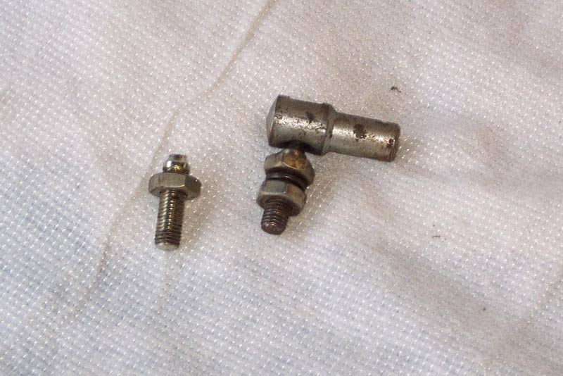

However, within 5 miles of home, my gearchange linkage snapped and I was stranded on a roundabout! Luckily I managed to gain access to the gearchange mechanism (gear lever end) and was able to get the car into 4th gear and with a bit of clutch slipping, was able to limp home. When I bought the car the previous owner told me that he thought these parts (see picture, broken joint on left) were a weak link in the gearchange mechanism and had bought some spares. I fitted one and was away again (although being MUCH more careful with the gearchange!.
I presume it would be quite straightforward to change these ends for rose joints (rod ends) which would make it a better and more secure joint.

The rod ends in the picture above are ONLY fit for throttle linkage on our cars. The standard rod end 8mm. or there abouts is what is needed on a gearchange. Use good quality morse cables and make sure that the mounting points are RIDGID and all should be good.

Little rose joints on the cables instead of the horrible ball joints, and careful setting up will give you an excellent change system.

I had two of those joints break on my car whist building it! They are just not up to the duty.
You are right, they are easy to replace with rose joints. Working from memory (so please check and in any case, your cable end threads might be different) the threads are 3/8BSF and a 6mm stainless bolt fits nicely in the rosejoint hole to bolt on to the gearchange plate. The only thing I had to do was to file the underside of the hex heads on the bolts as when the cables are at full push or pull, the angle of the plate to the cables is such that the underside of the hex head was fouling the rosejoint body. Maybe setscrews would get round this, but you can't get them with a shank so the fit in the rosejoint hole isn't as good.

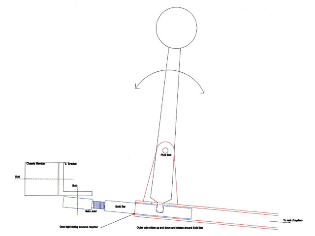

If I were doing the gear change again, with my current knowledge and tool kit, I would stay with a rod change and most likely utilise the design at the front end as used on some of Mike's race cars in his toy shop, his Lola being an very good simple example. I will try and attach a drawing to this post with a sketch I did for someone a while back. No gauarantee of success! The design at the rear I would try and improve by making it much tighter to the gearbox casing as the further out it gets the more amplified the movement of the gearbox/engine is. I also thinks it needs dirt protection as it is rather exposed. One grain of dirt in any rose joint and it can lock up solid requiring a big effort to free up. So far I have been lucky not to have this happen to me but others haven't been as lucky.
