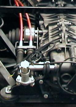

can anybody tell me the best way to set up the above linkage
i using a center tunnel change the cable's connects to the looking from the back the left hand side of the gearbox and i want a conventional 1st top left gear change also any pics of the brackets used for the stay arm would help any info links or pics will help no matter how small

Hello again -
Found this if it helps from Daves R42. I'm sure he will let you have a look at his setup if you are interested. Let me know or mail him at dave.parker@gtd40club.co.uk

where can you get this type of translator it looks the bizz
lotus don't stock anything anymore??????? [img]/ubbthreads/images/graemlins/crazy.gif[/img] [img]/ubbthreads/images/graemlins/crazy.gif[/img]
