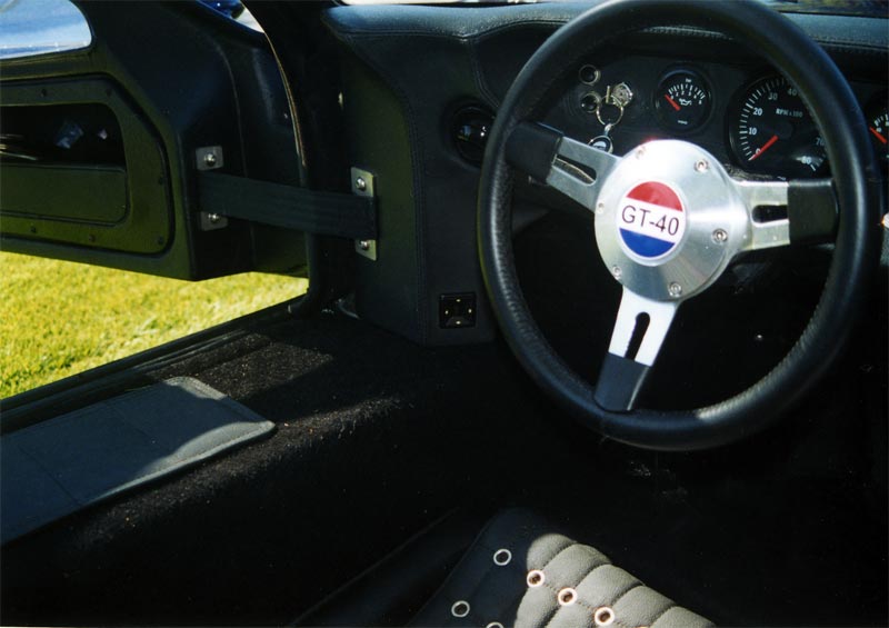

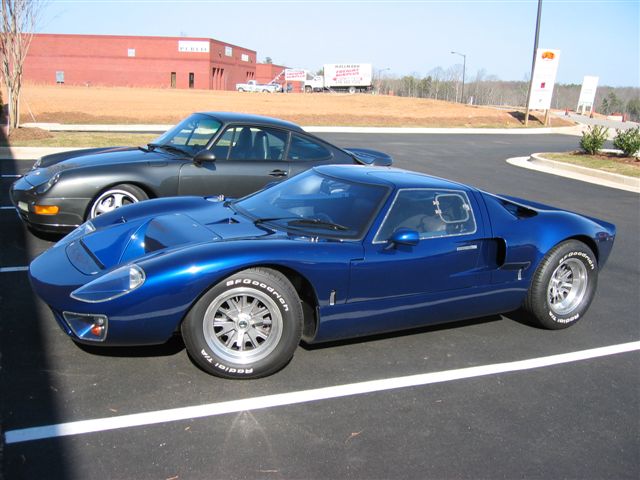

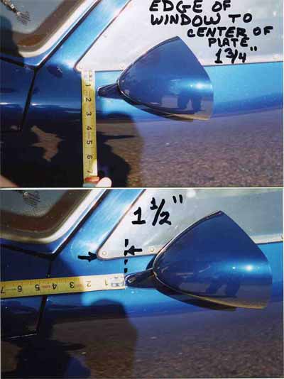

A lot of us are using '85 to '87 Mazda RX-7 electric mirrors. They look great and are period correct and work very well. In this picture they look like they are drooping, but they really are not. You need to sand the plate that goes against the door to make the top of the mirrors be paralell to the pavement. This is the position I installed them. They are available in most braker yards. I also used the control switch from the Mazda. [img]/ubbthreads/images/graemlins/smile.gif[/img]

Re: Box full of nothing
Side view

Control switch at 8 o'clock just outside of the steering wheel.

Mike DD and all others, My neighbor down the street, ( gray Porsche in photo with over 660 hp ) is an electronic Geek and sat down and played with it while watching TV and figured it out. The next day he installed it ( hard wired ) and after it was sauldered and plugged in with a 3 amp inline fuse in about 2 hours it worked the first time and I am sorry that I can't help with the wireing. I do know that he made it much more simple than the wireing diagram that we could not get to work. Good luck. Joe [img]/ubbthreads/images/graemlins/frown.gif[/img]
