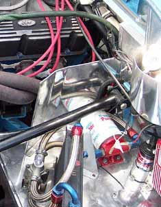

I would guess everyone is right with their answers here. When I bought my car, the builder told me he had fitted two separate switches for the pumps instead of a right one on or left one on type switch. He told me he used to switch the pump off slightly before he got anywhere on a hot day so the fuel was drained from the carb and refilled with fresh, colder fuel on startup.
Also he fitted two polished ali "guards" either side of the engine (see pic, rhs shown) to cut down on the radiated heat from the manifolds.
Simon

OK - An update....
Armed with a print out of everyone's thoughts on the subject, a friend of mine Neil, an excellent machanic, who is not frightened of the car and I, set to work. Frightened of the car? So many people shy away from doing anything to the car - its too specialist. ITS JUST A BIG V8 - for Gods sake!
We both agreed that we had solved the starter mo
