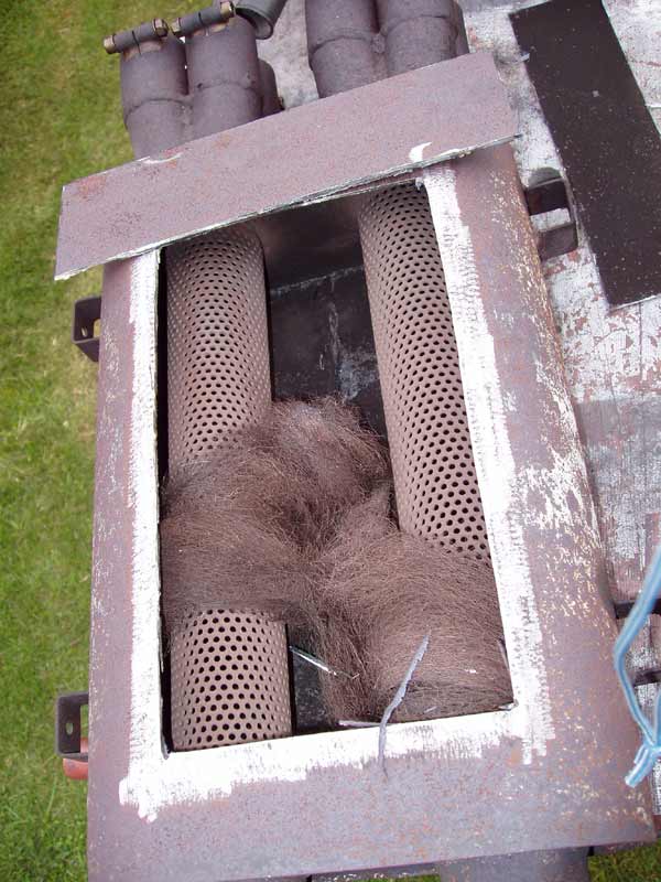

I guess this'd be why then...... (see pic)
Simon
Incidentally, it's built out of steel thick enough to build a battleship from (well...almost) [img]/ubbthreads/images/graemlins/smile.gif[/img]

Don't think it looks like long fibre wadding Lynn, but it's cheap enough to replace once or twice a year, I suppose.

I've taken the plunge and ordered two rolls of exhaust "wrap" that goes around the baffle and a bag of loose wadding to fill up the void. Will let you know how it goes.

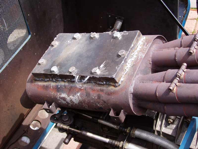

Update:
Finished re-packing the exhaust and fitting my removable "door" (please don't laugh at my welding)
Hell of a difference! Still loud (big lumpy cam) but MUCH better than before, it's taken the hard "edge" off the exhaust note and turned into a loud rumble. Hopefully it will stop me getting a headache every time I drive the car.
