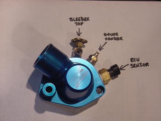

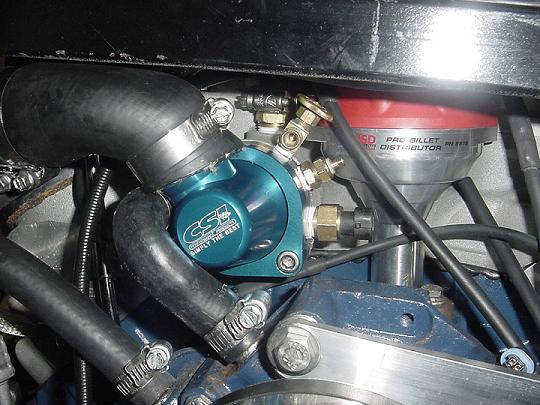

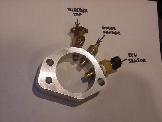

To add to my problems, my TWM manifold has only one water port, so I was forced to seek sensor(ECU water temp & gauge sender) ports elsewhere. I decided that the thermostat housing was the best, most accesible spot where I could add sensors, without tearing apart my throttle bodies and manifold, for access with a drill. I also added a bleeder tap(still in need of a barb and hose), as this is about the highest point in the system.
The (7/8" thick)spacer block cost $130 to have machined, the tap was free. I was concerned about clearance issues, but was pleasantly surprised to see that I had tons of room. I have 1/2"+ between the upper water pump hose/thermo housing and the bulkhead panel, and loads of room around and above the sensors/tap.
I will be bleeding the system later today, and will post the results.

Lynn,
So far, so good! 184-188F BEFORE bleeding(idling for 30 minutes after warmup in 90F air temp)! I'll be bleeding it tonight(it's raining again!) and road testing tomorrow. I hope that the temp stays right where it is!

Trevor,
I only had one water port on my manifold. I had a heater
hose, ECU sensor, and gauge sender to plumb. These were the
primary reasons for the spacer. I added the bleeder because
there was extra room in the spacer, and because I hoped
that it would release any air from the front of the
manifold that had not been purged to the expansion tank. I
bled it today, and sure enough, there were a few bubbles in
there. After bleeding it, I ran the car pretty hard, and
had a temp spike that went away pretty quickly, so I am
assuming that there's more air to be bled. With the
bleeder, this takes all of 10 seconds and it's done.

Trevor,
I forgot to mention that the manufacturer of my manifold
(TWM), suggested drilling the manifold directly behind the thermo housing. As I'm not a masochist (didn't want to dismantle everything to accomplish this), my spacer was a whole lot easier and simpler way to get the same result, without all the pain!
If someone was so inclined, they could re-route their heater bypass hose into the spacer(plug the T-stat housing hole for the bypass hose), to allow a better angle where the large hose exits the housing.
Trevor Booth
Bill,
What you have done is very nifty, much better than drilling and tapping the manifold. It sure is a tight squeeze under that crossmember. why dont you cut 6" out of it..:-)))
Trevor
