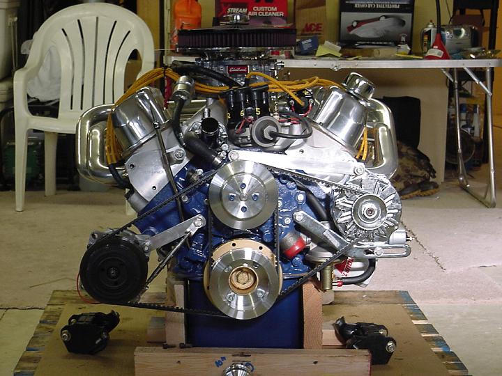

Guys,
Lots of good info ... thanks. Let me explain a bit further. I told the engine builder that the engine had to be short ... and gave him a dimension. At best he apparently forgot or at worst he ignored my requirement. The engine is built ... and is way too long to fit in my car.
Picture:
As you can see, it has three levels of belts. The first drives the oil pump. The second drives the water pump and a/c compressor. The third drives the alternator.
I'm thinking that I'll need to replace the a/c compressor, the water pump, and some other things like the a/c compressor bracket. I'll have to shorten up the stand-off for the alternator bracket.
If I use an Eplorer water pump ... do I have to replace the timing chain cover?
What other things will I have to do that I don't yet recognize?
Thank you all VERY much!
Mike,
You will also have to use a lower profile rocker cover breather! This one is not going to fit under the 'shelf' unless the engine is very low in the chassis.
Mike, that water pump that is on there is using a serpentine belt and appears to be short. There won't be any help there. You may have to put a blister in the firewall cover to give relief. That's be the first choice, IMHO. The dizzy and valve covers do look damn tall though.
Mike,
The multiple groove pulleys aren't going to help at all.
Can you rig a single belt setup with an idler/adjuster,
instead of the three belts?
Get rid of that front row of pulleys, and you should have
enough room from the front of the engine to the bulkhead
(assuming you have a water pump blister in the bulkhead
panel).
The distributor should be OK, although it's kinda tall.(MSD
makes a shorter version of the Pro Billet)
The valve covers might just make it, but in no way is that
oil breather going to work. Are those tall valve covers
absolutely necessary to clear the rockers?
Good luck getting it in there!
Bill is right, maybe go to two levels. There is no reason the alternator should be on its own, use the serpentine you already have to turn it. Move it back an inch or so inline and that would help a lot.
Here is a shot of my custom made serpentine setup mounted in the car. It does not require a bubble on the firewall. It uses a single belt for everything and includes the street rod water pump.
OK Guys,
How do I tell if I already have the short pump (I really can't imagine that, by the way)? Does someone have the dimension from the front face of a head to the outside end of the pump snout?
What I have are flat belts, but not a serpentine set-up. I'd agree that going to two layers of belts is the idea. I hope I have a long pump installed. Changing that might allow putting the oil pump belt outside the other belt. This would put the longest dimension in the place it can be best tolerated.
I believe that a length of 6" to 6 1/2" from the head would be idea. Currently it is at 9" ... way too long and longer than the engine in my Cobra which is (I believe) built with a pretty stock serpentine setup).
Again ... Thanks Fellas!!!!
mike
A little more data. The pump I have is about 5.5" tall from the back where it meets the timing chain cover to approximately the inside of the pulley mounted on its nose.
The distance from the heads to the outside of the first pulley on the nose of the water pump is 8" and to the outside of the second pulley is 9".
