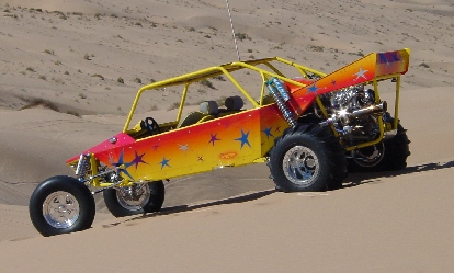

Here's a great application for a Mazda Turbo Cosmo 2-Rotor (1300cc) - 584 hp @ the wheels (I should say 'Paddles')
