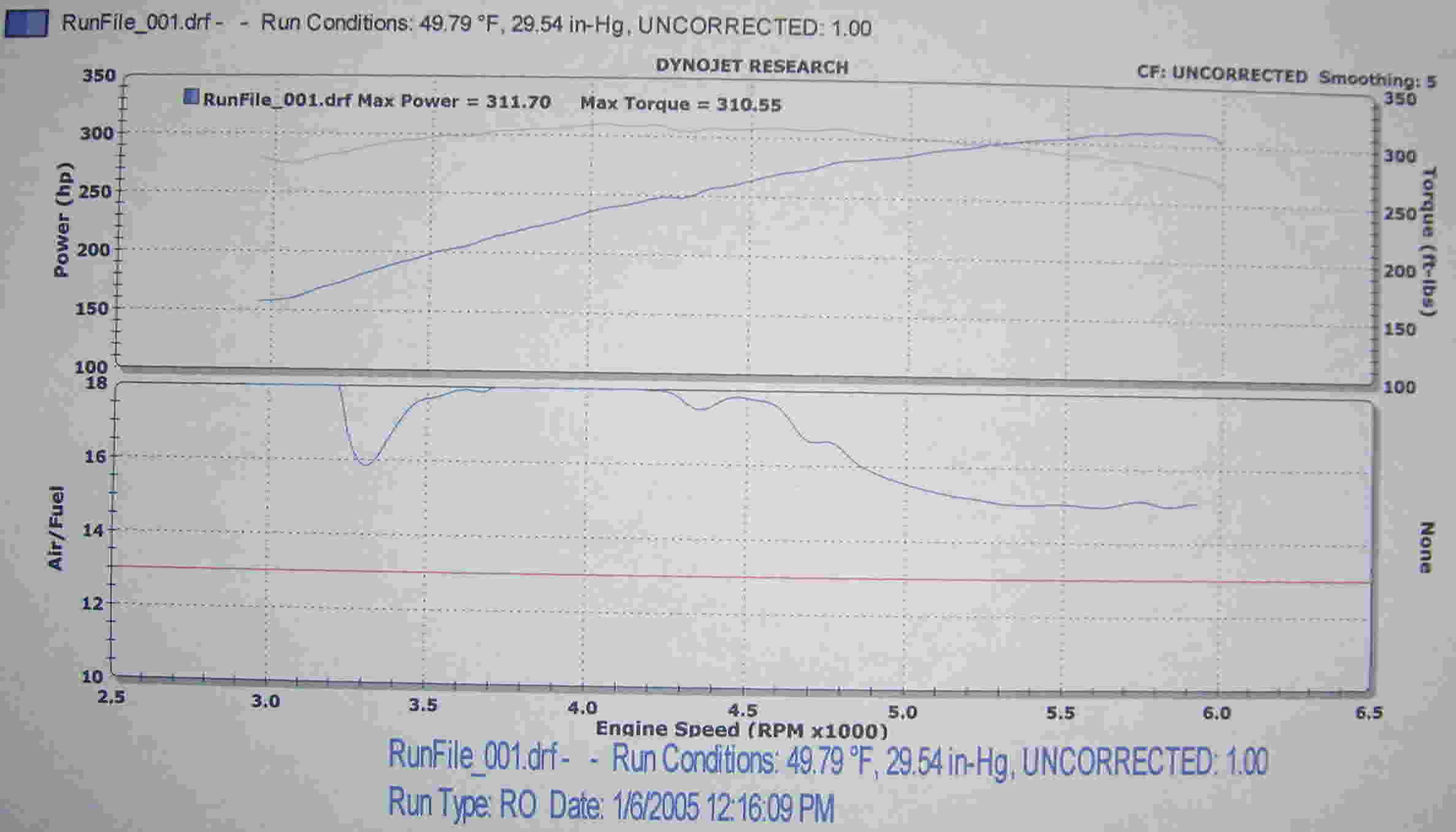

Run 1 – Car warm from drive over-too lean
HP-311.70 TQ-310.55

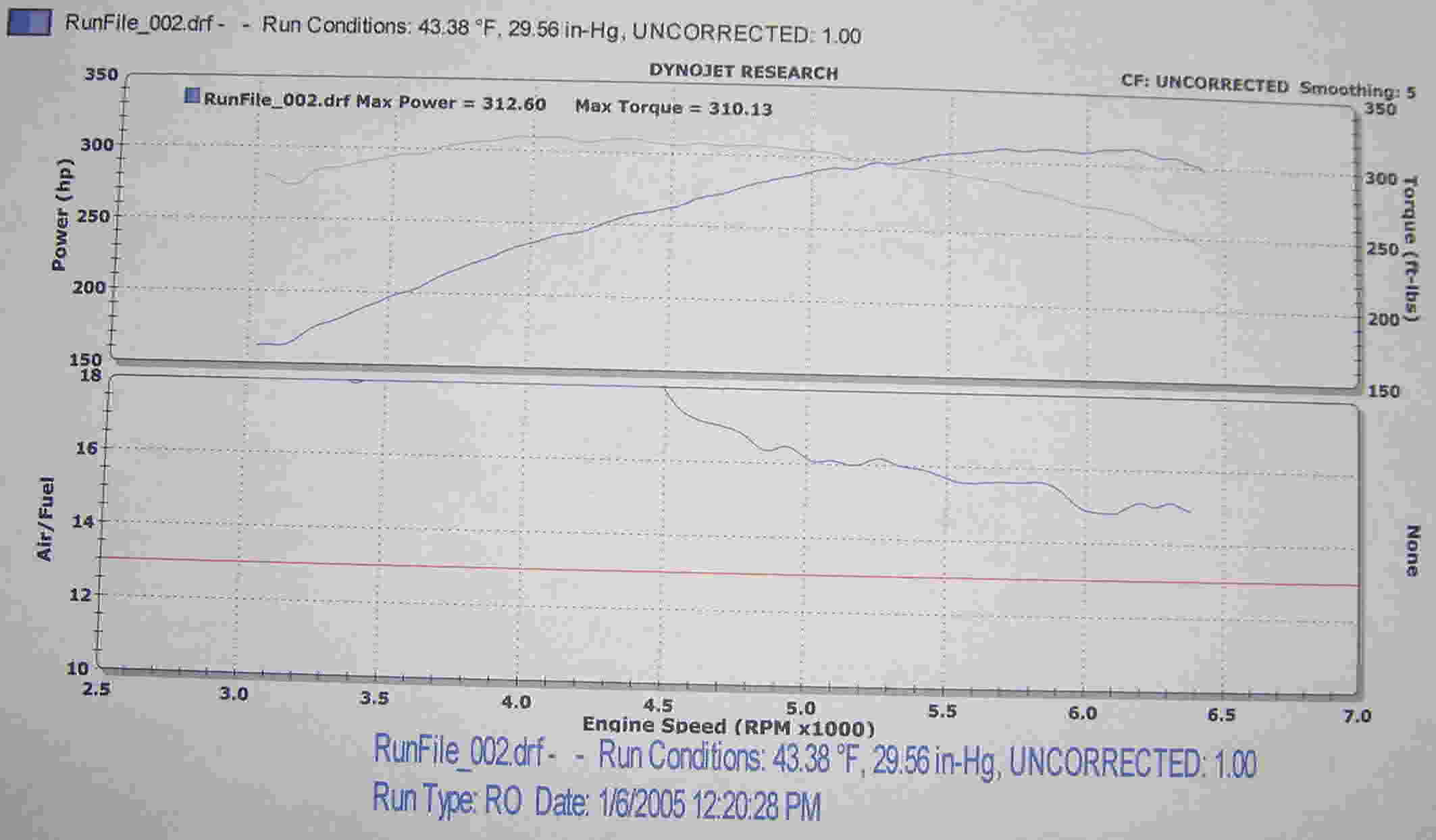

Run 2 – Car hot – Fresh fuel in secondary bowls-too lean
HP-312.60 TQ-310.13

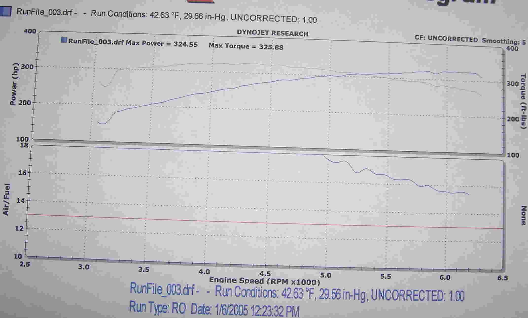

Run 3 – Car hot – Manually opened vacuum secondaries-Too lean
HP-324.55 TQ-325.88

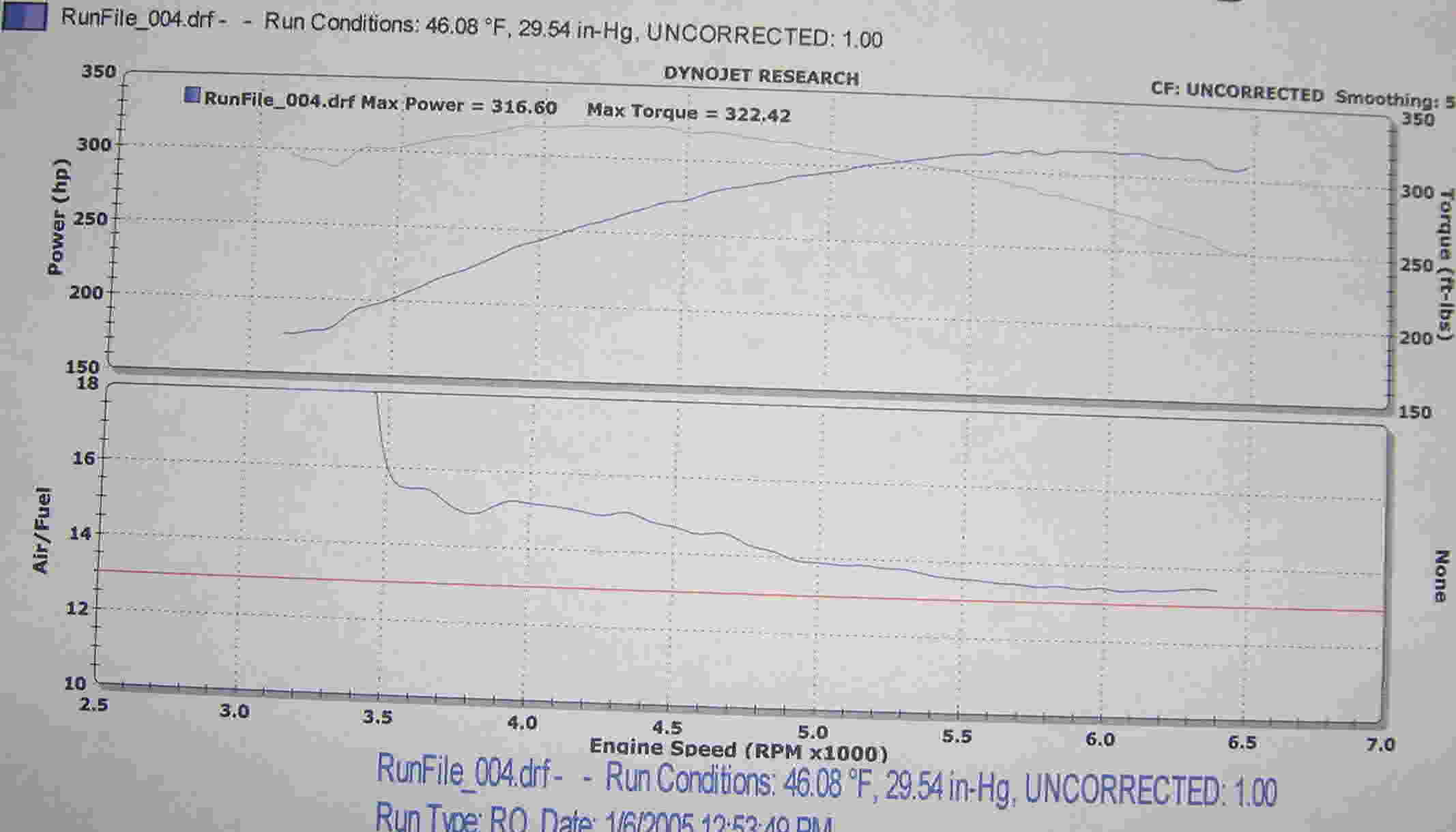

Run 4 – Re-jetted and air filter off – Car warm-richer
HP-316.60 TQ-322.42

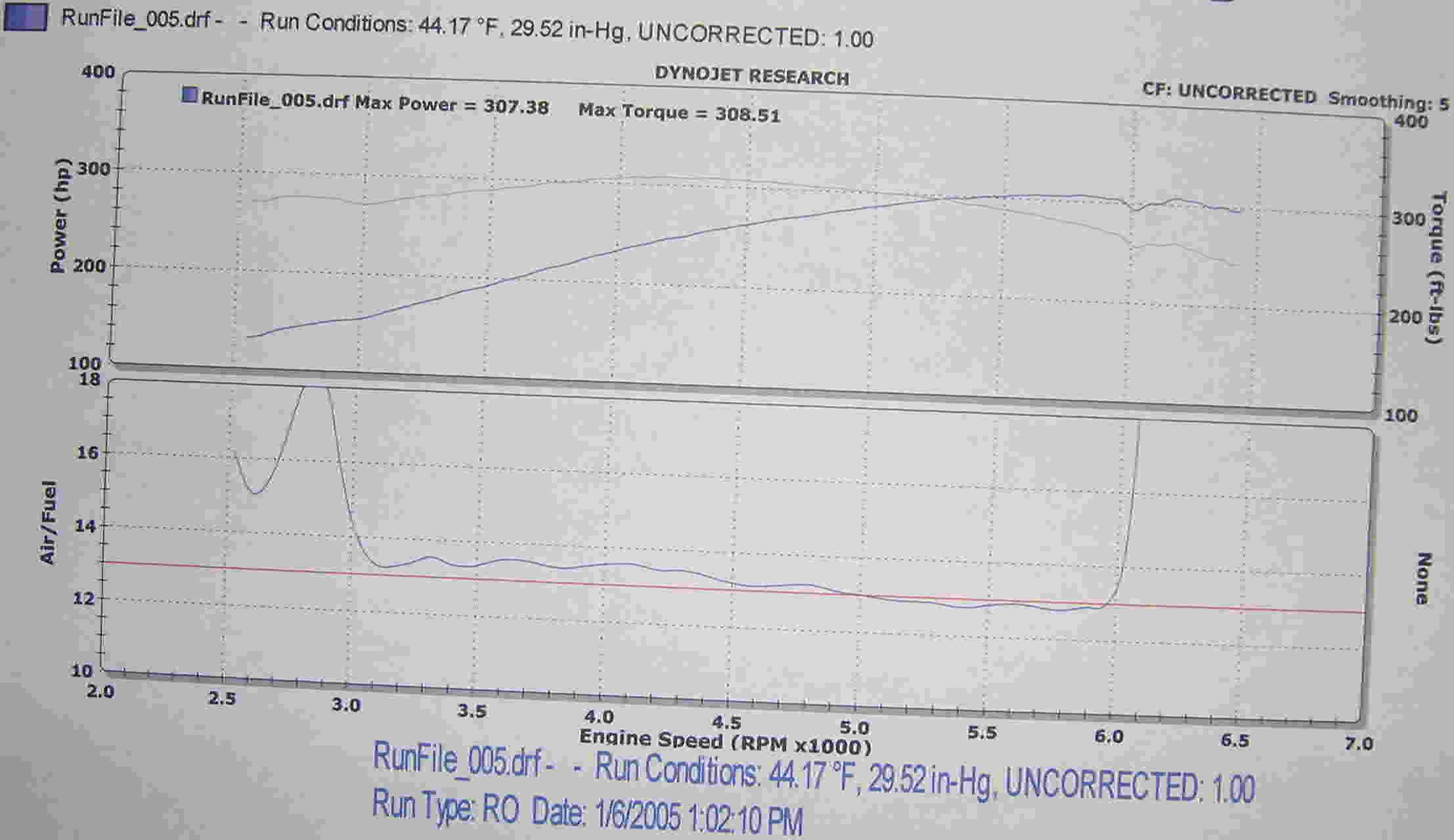

Run 5 – Re-jetted and air filter on (K&N with filter top – Car hot-Fuel just right
HP-307.38 TQ-308.51

Ok,
Here are the individual run sheets!

Run-2

Run-3

Run-4

Re: Keith Craft 331 Econo Stroker Motor
Run-5
--->Ron, please delete any of these pic's you believe are irrelavent to the post after a week or so... If no one has seen or read it by then, no big deal...
Thanks,
Tom
