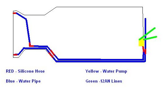

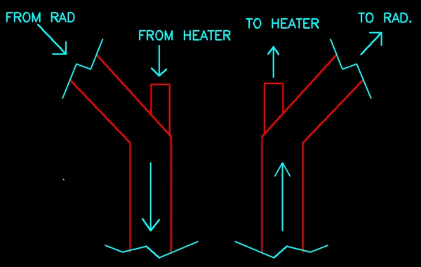

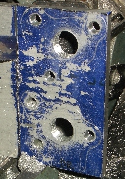

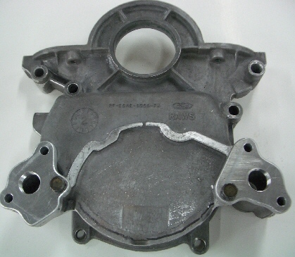

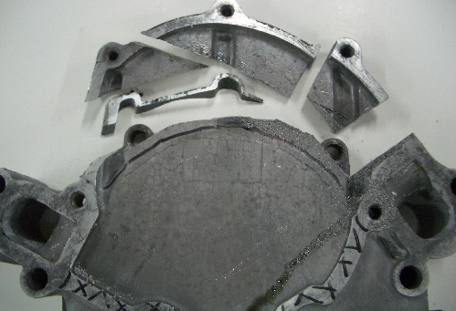

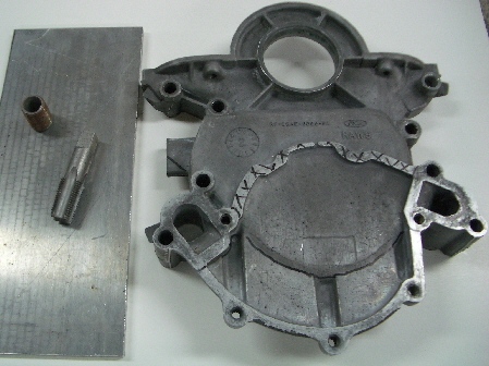

Mounted inline near the engine with 1-3/4" hose inlet and 2 -12 lines to the engine. Bagged the expensive and bulky adapter plate at the engine and went with two small 3 hole alum plates with 3/4" NPT holes for the -12 lines. Really simple to make. I even cut down the water pump face of the front cover.

5/16" (8mm) 7075 T7 plate, go with 3/8" for 6061
Start

Almost done. What's lighter, a water pump with the front cut off and plugged or 2 little plates with part of the front cover gone.
"does that mean the bulkhead cover in the cabin was reduced down so it doesn't protrude in as much between the seats?"
about 4" - 5" more clearance than the mech Ford short water pump, the firewall can be flat now, no bulge.
"also, was there a reason to mount the pump close to the engine rather than in front, close to the radiator?"
The plumbing was simpler with this model pump because it has 2 outlets which go directly to 2 engine inlets. Meziere makes a 1 inlet 1 outlet pump which you could put in front but it costs more.
