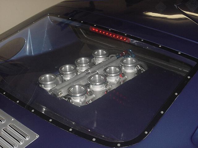

It's a TWM induction EFI manifold. Attached is a photo of what one looks like finished and in place. It did require
a few minor modifications to fit, but nothing too troublesome. Well worth the effort!
Throttle response is incredible! [img]/ubbthreads/images/graemlins/cool.gif[/img]

Looks great Bill [img]/ubbthreads/images/graemlins/cool.gif[/img] - what injectors are you using? (make/flow) and are they batch fired or sequential?

Welcome to the world of 8 stacks. [img]/ubbthreads/images/graemlins/smile.gif[/img] Better setup than my Aussie DC&O unit. I hope you are going to run filters. [img]/ubbthreads/images/graemlins/blush.gif[/img] [img]/ubbthreads/images/graemlins/smile.gif[/img]
I think we should now be calling you "Bad Bill". That engine looks mean with those stacks on it now. [img]/ubbthreads/images/graemlins/cool.gif[/img]

We haven't selected the injectors yet, but they will be either 32# or 36# fired sequentially with an electromotive setup. I really like the distributorless setup for several reasons. first there is the tight fit of the distributor with the fuel/water lines. second The system is very simple and gives a better spark and duration than distributor or CD units. It uses a 60 tooth crank sensor for tighter control. The spark is for a Full 2 milliseconds up to 15,000 RPM as oposed to the .1 to .3 for the other sysems. That equates to 90 degrees of spark. Better burn, more power, easily tuned with a lap top. Setup the A/F ratio and you are good to go regardless of the altitude. Check out their web site for the complete story.
