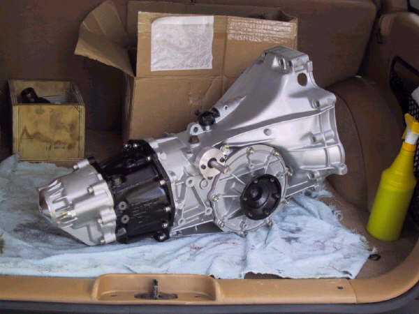

That is because manual 016 equipped Audis were never imported into Australia (unless they were done so privately). The chance of finding one is slim..... On the 01E front, the box you are after is out of the 2WD A8 and as you can imagine, this particular vehicle has never been sold into Australia by the importers. Whilst there are plenty of manual TTs around, they are of the quattro variety and not suitable to "our" application [img]/ubbthreads/images/graemlins/frown.gif[/img]....
Your best bet is to import one - 01E from Germany or eastern Europe (don't know how you would do that...) or to go through a breaker yard and shipping company for an 016 box out of the states. If you do go for a box out of the states, it is probably a good idea to get a couple of boxes at the same time.

Thanks for the info, i'll look into it. That picture is a tease, where did you get that transaxle from.

Certainly is a tease... [img]/ubbthreads/images/graemlins/wink.gif[/img], sorry about that.... Actually doesn't belong to me, it's a photo I took of an 016 box that was lying around in the RF workshop about 2 years ago being fitted with an LSD and is probably now in one of the RF cars sent to the States...
