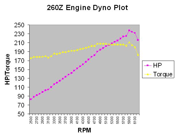

Well, what the heck. Here is a chassis dyno plot from the 260Z that I race (try to race I should say, maybe next week I won't catch fire). Inline 6, 2.6L, stock carbs, cam, etc. just attention to detail with port work, cam timing, exhaust with headers, and some other tweaks. IT is very restrictive so we can't do much.
Not a lot of power, only about 225 (ignore the bump there) and I don't think it is a real "225", that is just this dyno. I'd estimate only 160 at the wheels or so, but it is still mighty fun in a 2600lb car on a track!

Ron, You mention stock everything, What was the HP rating of this motor from Factory. My cousin has the exact same car with FI and it is a dwag.. Did you do anything else besides the porting?!

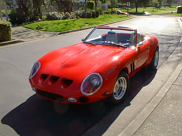

By the way here is a photo of his 260Z (It is a VR rebody out of Arizona)

Nice!!!! Ours doesn't look anything like that, but it is a race car and not for he street. I like those headlights.
We don't think the motor is making that sort of hp in the graph, that is the engine dyno shop that is off I think. The motor has compression bumped 0.5, good port work, great header and open exhaust, along with a lot of pulls with the cam timing at various points. I think the motor is probably putting down a solid 175-180 at the flywheel - no more. Oh, and a lot of custom work to these POS flat top carbs that everyone hates - but they run well. They were rated at 135 from the factory but that was in smog trim from 1974.
It pulls strong and has a nice flat torque curve by feel. It'll hit 132 easy at 6100 RPM and will continue to pull to about 7100 which we have to do at the longer tracks like VIR (next weekend). Definitely not the strongest ITS car in the class but no slouch either.

Ron, you're 175 - 180 HP guess with all the work you've
done sounds about right. IIRC, my '72 240 was rated 160HP
stock form the factory.

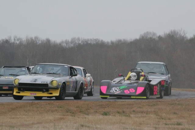

This is me getting ready to get stomped by thta spec Racer Ford taking me on the outside and my friend and business partner with his TR8 on the inside! Rookie drivers have bad lines!

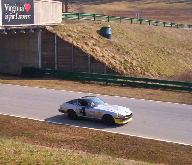

And free and clear of traffic - smooth sailing!

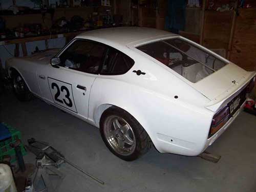

Ron this was the 240z race car before I sold it.A great car.

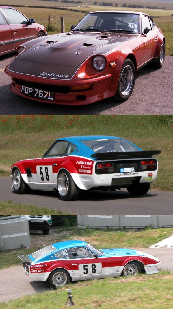

Hi Ron /all
Yep - Retro cars are cool!
We have come across a few on the hills - like these two at Gurston Hill climb. The 'Z-Engineering' car was especially nice, but was unfortunately totalled when driver lost it near the finish and hit a wood pile alongside the track. [img]/ubbthreads/images/graemlins/frown.gif[/img]
Flippin quick though and sounded just awesome..
