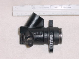

Here are two pictures of my clutch slave cylinder. It mounts to the bell housing of my Renault 5 speed UNI trans. I've been to a couple parts warehouse people that can't find a replacement. The only numbers to reference on the unit is 'S6432'.
If anyone can help, I need a part number and/or car it can be referenced to. I will call Andy at Tornado if all else fails but I'm counting on you guys. Thanks in advance.

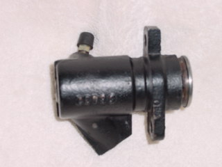

And the 2nd picture: (btw, USA)

the clutch slave cylinder is from a renault 21 turbo both series 1 and 2 the cylinder was fittted to virtually all the rennault 21 turbos and is fairly common it can still be purchased in the uk for around 25-50 gbp depending if you go to someone like bettaparts a hydrolic wheel cylinder supplier we use or delphi from another supplier i will find out the part number and post it here if you have problems locating one in the us give me a pm

Check out Delorean parts. I bet you it is the exact part you need. If I am right, you owe me a beer (40oz) [img]/ubbthreads/images/graemlins/grin.gif[/img] And it is cheap, meaning more money left to buy me more beer
http://www.specialtauto.com/delorean...nsmission.html

I knew you guys would pull through.
Faili, it appears to be identical.
With Mike's offer I can buy you all a few rounds, all 40oz [img]/ubbthreads/images/graemlins/grin.gif[/img] Mike, as long as it is in good shape a doesn't need a rebuild then I'll take it. I'll pm my info.
