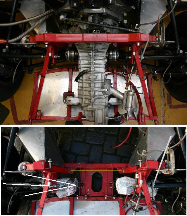

In relation to your question about suspension point location - this might help. Picture shows chassis rear on Roy's modified GTD. The yellow line shows where standard chassis member normally passes and white shows sus arms.
Note that Roys engine is also forward a little too (50mm?)as the lower rear crossmember normally fouls part of the gbox/bellhousing which prevents the box being lowered much.

Hey paul, thanks very much for those photos and the trouble you must have gone to to get them. If this installation is typical, then my "brainwave" is not an option. Quite simply, I was going to suggest the use of an ali engine "plate" of say, 1/4" thickness which mounted between the engine and gearbox, suitably cut out for same, with allowances made for extra length input shaft shaft etc, notched to locate on frame rails and bolted to horse collar. In drag racing, we used such a plate mounted at the front of the engine (in a front engined configuration) suitably cut out for ancilliaries, which anchored the motor firmly to the chassis rails forming a solid tie together with solid engine mounts in the appropriate location and triangulated shock tower/firewall bracing. This provided the very best resistance to torque induced twisting moments on launch. If you can see where I was coming from vis a vis the '40, if the engine/trans joint was close enough to the chassis suspension pick-up points, then such a plate would bear much of the transient loads induced by both engine torque and suspension effort without unduly stressing the motor itself and "solidifying" the entire drive train/suspension package. This may have solved a problem for the chassis lacking in a lower cross brace in order to gain a lower motor placement. Unfortunately, I have not been close enough to a '40 for some considerable time, so I was unable to do more than simply "theorise". Thanks again for your time. Back to the drawing board! [img]/ubbthreads/images/graemlins/crazy.gif[/img]

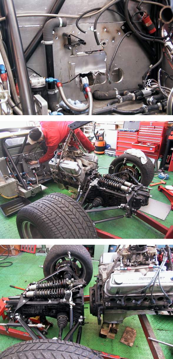

Keith - I suspect this '40' is what you refer to (sort of) - the motor mounted to a 0.5" thick alloy plate at front (pulleys poked through plate) and the rear of the engine also bolted to a fixed plate across the chassis. A neat trick was the suspension all mounted on the gearbox - made it light too.
Another of Mr GTDs (RC) creations [img]/ubbthreads/images/graemlins/grin.gif[/img]

Indeed Paul, that is exactly what I'm talking about, although .5" seems a tad excessive. Belonging to the Barnes Wallis school (if it won't break, it's too strong/heavy) I would have thought that 1/4" plate would have been ideal as there presumably would be no bending loads on said plate. Getting back to my original comments, a motor so mounted at or near the rear suspension pick-up points, could possibly solve the potential problem of chassis flex where a lower crossmember cannot be fitted for motor mounting height reasons?

Hi Keith - 0.5 may seem a bit thick - but I seem to remember that the plate was being used 'structurally' too, so to speak and the chassis was very light around it. It certainly accelerated well from what I recall when I drove it and with a 'cooking motor' so it must have been light.. [img]/ubbthreads/images/graemlins/smile.gif[/img]

Crikey! Just realised what I was looking at!! Inboard shocks > pushrod? Gearbox used as "stressed" member (with a cage)? Now you're talking! What happened to this arrangement? Is this not practical for your average '40? [img]/ubbthreads/images/graemlins/tongue.gif[/img]

Exactly what I was thinking. There is some real thinking outside the dots going on there.
Paul
What happened to that car?

If any of you have access to a Porshe Carrera GT(get to know your shop forman) you can see the arrangement. Quite simple really. Just have to think about how you want it laid out(the shocks that is).

I came across this car on a visit to the factory in Poole a number of years ago. It was in the yellow roadster 40 of Ray Christophers - AKA Hairy Canary if I am right. Unless changed since its still competes in the UK now.

I wondered when the penny would drop! - Ray has always been one for innovation - and this system caused quite a stir when debuted in the Isle-of-Man in 1999. Im not overly sure the scrutineers knew where to look first....

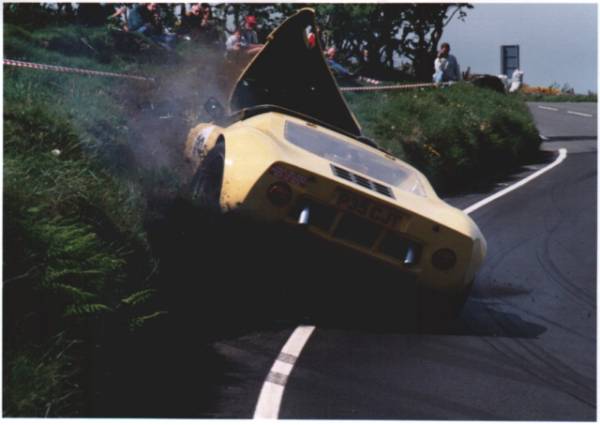

Anyway - it performed well, surviving a fairly large knock at the 'goose-neck' on the big Lherghy-Frissel hill climb (see below). He couldn't continue though as a suspension arm bent (track rod end held!). I believe Ray still has the car somewhere - or thinking about it, he might have used some major parts in the current spyder. The suspension had been done before on his R42, which also had inboard shocks with push-rod actuation. I remember when we were removing the engine for a rebuild, we unbolted what seemed 'just a few bolts' and then wheeled the trans away complete with wheels, susp, driveshafts etc etc - very cute!
By 'cage' I assume you mean to transfer load from one side to other at rear suspension points - YES it did, all very light though...
