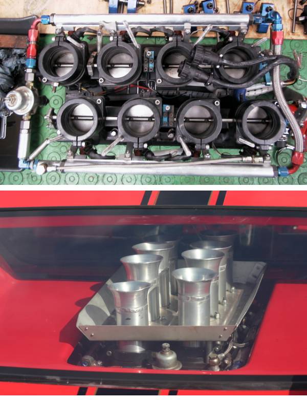

Hi Dave -
58mm / 2.25" on a 347. Worked well on previous 302 too. [img]/ubbthreads/images/graemlins/cool.gif[/img]

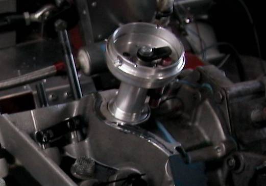

We run sequential using Motec M48Pro - We have a modified distributor to provide cam phase for sequential operation and use 8-coils for ignition (not wasted spark).
I have also previously modified the bottom pulley on SBF to provide signals to Motec via a hall effect pickup - Interestingly it gives absolutely ZERO ERRORS in comparison to the Magnetic sensors we use on the MSD on Roy's car, which will occasionally give errors, probably due to the large variation in signal amplitude. I have spoken to several engine builders/dyno operators and they say they never fully get rid of the errors using mag inputs.. although motors run fine.
I wrote an article in previous club magazine detailing just how to do this, and set it all up (DIY TRIGGERS - Winter 2004) if it helps. [img]/ubbthreads/images/graemlins/smile.gif[/img]
(ps - I believe there is a part from Ford (Ford Explorer??) that replaces the dizzy and provides both ref and sync from one unit although others would have to confirm that it will fit your designated block)
Modified Dizzy
