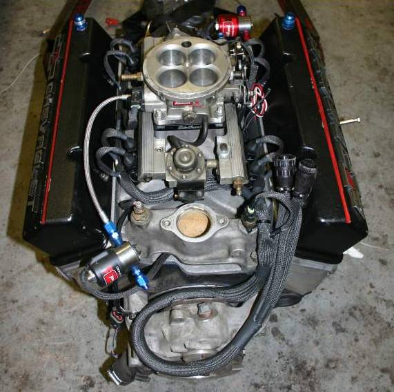

The Edelbrock Pro-Flo system that Hersh mentions is very good too and whilst being based on a batch-fired Weber Marelli ECU (like Ford Cosworth over here, F40 and Lancia Integrale - to name a few others) has a clever little module added to allow the seetings to be 'tweeked' from the supplied setup, to allow for individual engine installations. Edelbrock will also supply custom chips based on the details you give them re your engine spec. Not perhaps as tuneable (easily) as other systems but works very well. Also, the throttle body supplied will flow up to 1000cfm, with 2+2 throttle butterflies and an active idle control valve.
For Daves R42 we kept the throttle body and but have now fitted 8 coils + 59lb injectors + Motec M48 (sequential). Starts easy too! but the 100-150BHP of Nos has yet to be tested.... [img]/ubbthreads/images/graemlins/grin.gif[/img]
