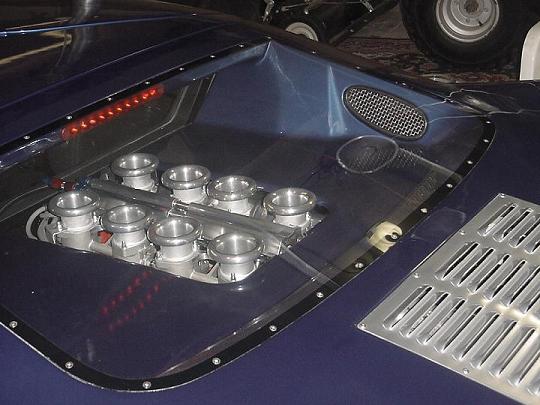

Like you, I was reluctant to add stack filters for aesthetic reasons, but I was a bit concerned with foreign particles working their way into the trumpets, so I added filters and screens to the intake holes in the rear clip, among other places.
I fashioned the filters out of 3 layers of household A/C filter media(dyed black with ink), The screen is gasketed with a piece of 1/4" vacuum hose with a slit running it's length(fit around the edge of the screen), and glued in place with black weatherstrip adhesive.
The filters are held in by vacuum only, but are a fairly snug fit. It's far better than nothing, and the "look" is still there. I'm planning on adding a cold air box to seal the trumpets from the engine bay, but haven't gotten around to it yet.
Total cost for filter media-$8. Ink-$2.50 Vacuum Hose-
$1 Weatherstrip adhesive-$5 Screen-$10+or-. Total-$26.50
There's a previous thread, with photos of the screens.
Attached is a shot of an intake screen. They seem to do the
job pretty well, 'cause each time I rinse them out, "ugly
stuff" appears at the bottom of the bucket!

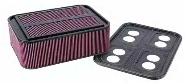

ITG makes filters that fit on Weber IDFs. They might fit
IDAs as well. Not cheap, but probably worth looking into.
Basically, you would have 1 filter per pair of trumpets.
http://www.itgairfilters.com/
Look for maxflow JC20, JC40, JC50 and maybe JC90 or
raceair JC10, JC70 and JC71.

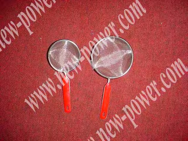

Is this whatt you are talking about?
Tea Infuser
They make 2 inch ones as well.

These might be even better!

I think we are talking about the samething. Here is a picture.

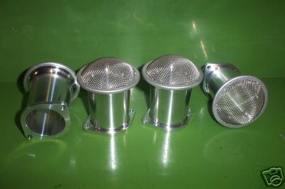

Here is an interesting approach. Maybe this can be modified to work.

Like this?

Yep, those look like the tea steepers I posted links to.
How do you keep them on? Little clips?
