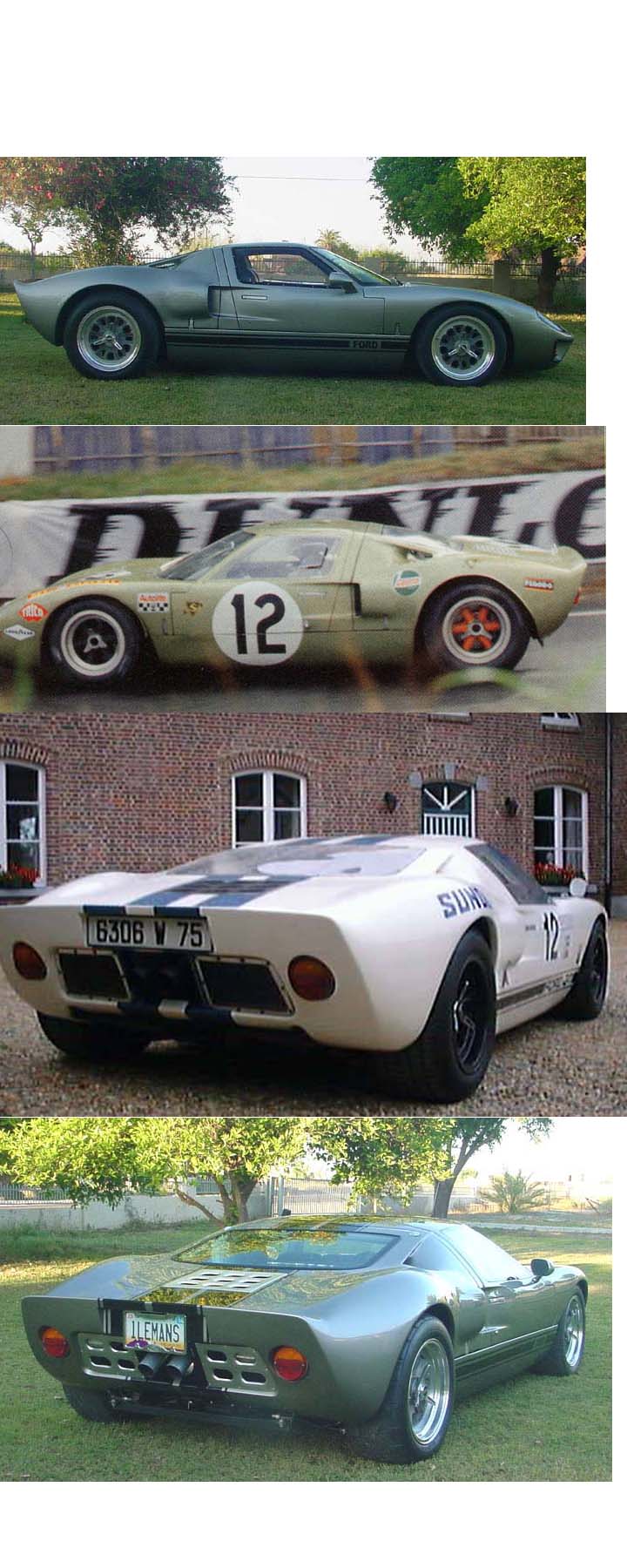

Here's a comparison of a RF to the real deal. I personally can't see that much difference in the ride hieghts. You can acheive just about any ride hieght you want by using lower profile tires or higher if that's what is needed . Shocks can be changed or adjusted along with spring tension. A whole bunch of adjustability can be had.
I've said it many times...The 016 IS a great box. It does a wonderful job for the intended use. Ther are just too many in use without major complaint to discard it. With minimal cost the fifth gear can be changed out for a better cruising gear. It's not going to take 3500 RPM clutch dumps at the drag strip but on the race track it's a great trans. These cars weigh very little compared to what the 016 came in originally. Regardless of engine size more than 500HP in this car is usesless IMHO. It just is not needed to get around most tracks we as Amateurs use. Unless you are a pro driver and race on a regular basis then excess HP is nothing more than a number to put on your show card.
Jerry's car has a 331 and it's scary fast. Chuck's 306 ci Gulf GT is scary fast. I think if you ask them they will tell you more HP won't make that much difference in the lap times. You need a huge track to use a lot of horsepower.
Maybe Jerry can shed more light on the 016 ratios for most tracks. His Driver Mike would be able to tell us how it does as well. If anyone else has experience racing with these boxes please chime in and tell us what the pros and cons are. Personally I like the 016 alot on short to medium tracks. Never been on a long track.
