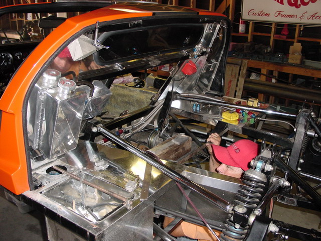

I had an MSD billet distributor on my 302 that interfered with the chassis. The previous owner nothced out the cross member if you look closly at the picture. I can get a closer picture later if you'd like.

doesn't look like your 'engine' has many horsepower.... [img]/ubbthreads/images/graemlins/tongue.gif[/img]

As you can see it's getting lot's of 'brain' power. And with the pea brains around here were tapping every cubic inch [img]/ubbthreads/images/graemlins/grin.gif[/img]
