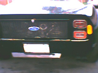

I hope all are having a good day today! I have just purchased a Fiberfab Avenger GT12. It's body is one piece with a engine access door in the back over the license plate. I knew when I purchased it that it had a VW engine, but I didn't know that it would sound like a go cart. I fell in like with the body, which is from a 1977 kit, and because it was so complete. I knew that my work would be very minimal since I am mechanically disinclined.
What engines can fit in my car in place of the VW engine? I look forward to reading your advice I really respect your expertise.
Sincerely,
T

Titus, it looks very nice mate.
My guess is you could probably stick a Porker engine in there.
Putting a Porsche engine in VW campers and the like has been done many times.
It will most likely be a tight squeeze, but certainly doable imo.
I assume it has a VW transmission too, so I'd look at fitting say a complete
993 engine & transmission. It won't be cheap though.
Oh, and lets have some more detailed pics please for those of us that have never seen one of these before [img]/ubbthreads/images/graemlins/wink.gif[/img]

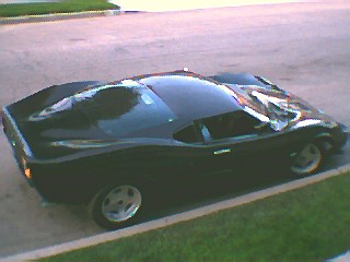

For those who asked, here are a few pics of my car. As soon as I get better pics I will post them.
Thanks Titus
Titus C is offline

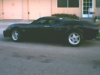

and another. . .

Old 09-29-05, 12:07 AM   #8 (permalink)
Johan's Avatar
6 Tenths
Join Date: Dec 2002
GT40: USA
Posts: 670
Rep Power: 15 Johan has much to be proud ofJohan has much to be proud of
Re: Please help replacing VW engine
Beautiful car. I say hop up the VW motor. There are plenty of ways to get a LOT of performance out of one. You could get another engine out of the back of a VW Hot Rod type magazine and go from there, driving your car all the while. Just remember that with horsepower comes the need for a stronger trans (if you switched to a V8) and better brakes.
Again, great looking car and good luck with it (perhaps try the Porsche 904 forum for even more detailed info on how to "hot rod" the car). I have ridden in bettles that burned a wheel for 50-100 yard.
Johan is offline
