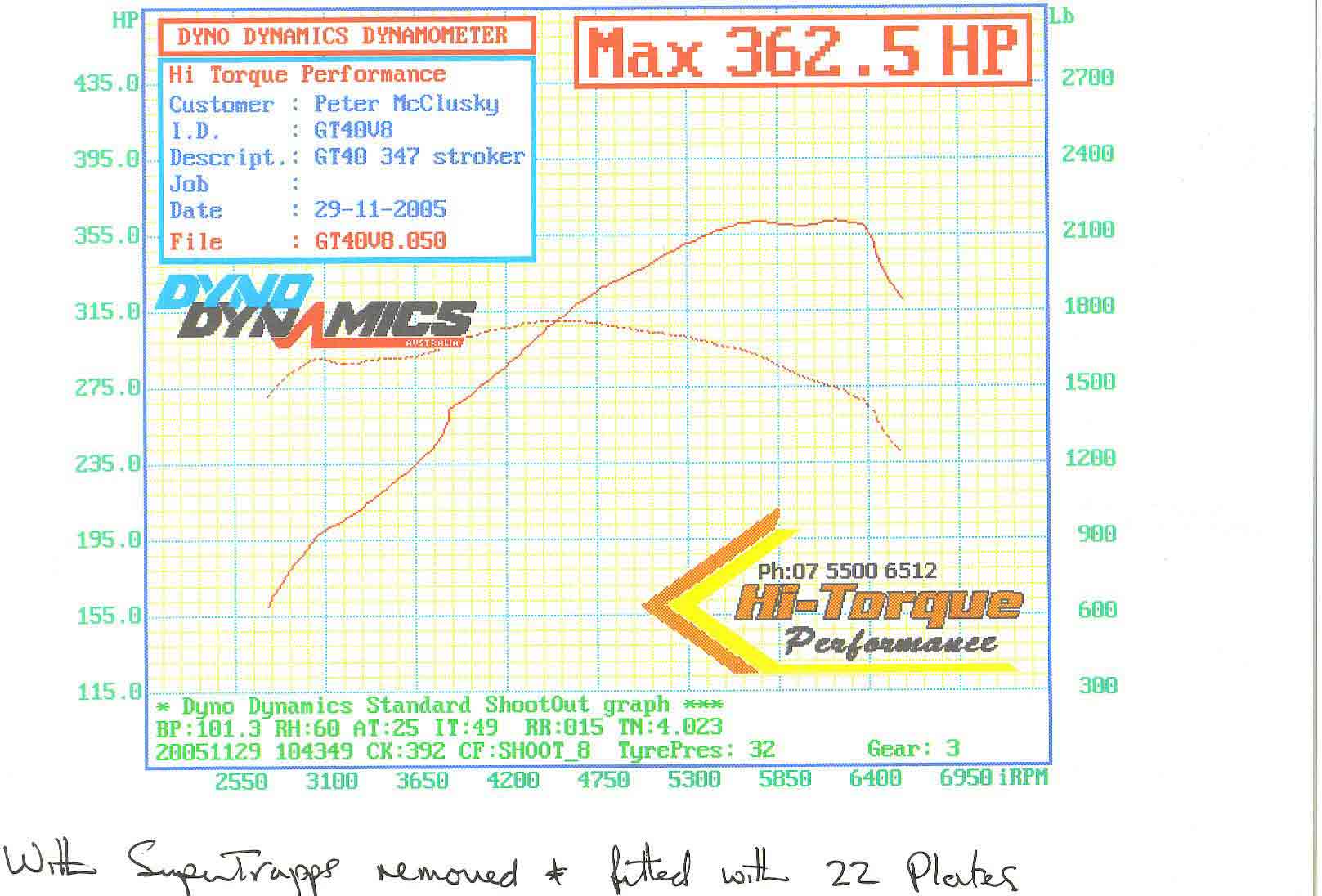

Pete McCluskey. Lifetime Supporter Dec 14, 2005 #1 We put #48 on the Dyno last week after 2500klms of running in. Managed to find 362.5 H.P.at the rear wheels and a healthy torque curve peaking at just under 1800 Ft lbs. We will have another look once we have passed 5000 Klm's. Attachments 70384-dyno-small.jpg 103.8 KB · Views: 277
