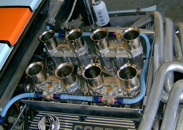

Hi Bill,
My vote is for 48IDAs, look the best plus they're original. Your going to have the same tuning issues to work out whether you go with IDAs or IDFs

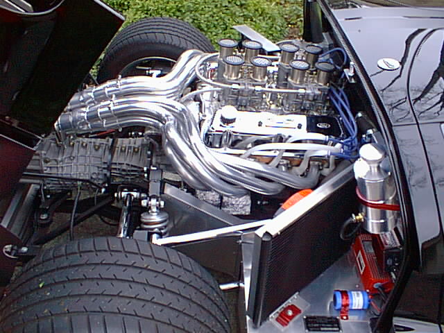

Bill,
I have 48IDFs, they run FANTASTIC (no problem of any kind). My car is for the street, Bought the carbs/manifold from Pierce (I think Ron also has the same set up). The cost 4 years ago was $2500 cash (and yes you bargin, you don't just say,,"YES SIR HERE IS THE MONEY") [img]/ubbthreads/images/graemlins/grin.gif[/img] [img]/ubbthreads/images/graemlins/grin.gif[/img]
347
10.75:1
600+ lift (solid roller) short duration
Edelbrock Vjr
