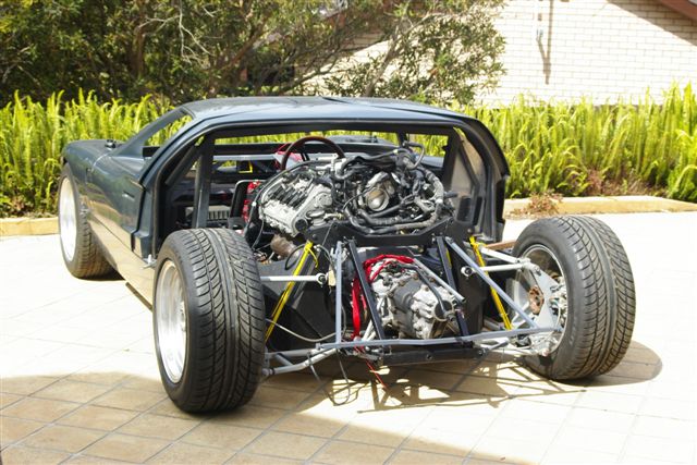

I had heard that there was a Lexus powered car here in Oz - Port Macquarie (a few hundred k's north of Sydney) - no idea of the owner or history though.
Here's an Audi powered one (in Newcastle, I think) - I know the owner's name, but that's all !

Hi guys I have seen two Lexus powered GT40s in Aus, one is on the NSW central Coast, a RF with eight throllte bodies. I have had the pleasure of driving this car and it is quite quick, and there is a DRB in Qld, I am going the LS1 Gen 3 please dont shoot me.
