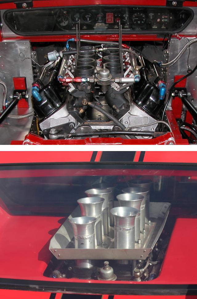

Hi Mike,
What size injectors are you running (cc/min or lbs/hr)? - what fuel pump?, what's the rail pressure (Psi)? and does the regulator have a vacuum connection from the manifold?
Finally, are the injectors batch fired (wired in pairs) or sequential (each wired alone and req's cam posn)?
We ran an early Accel Dfi system on Roy's 40 for a while and it worked well so don't lose heart and fall back to carbs - 'old technology', once you have it sorted it'll be great and knowing how to sort it will make any future plans you may have all the easier to achieve... [img]/ubbthreads/images/graemlins/smile.gif[/img]
