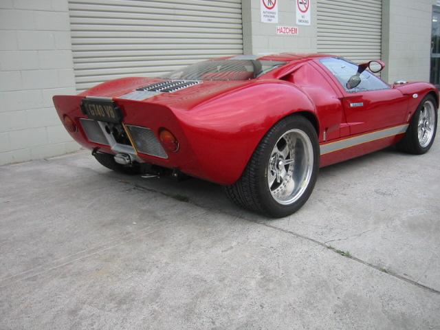

Flatchat and Ron you are both spot on.. But don't the flares and the fat tires look cool? [img]/ubbthreads/images/graemlins/1poke.gif[/img]

Pete, I hear you on the tires, they look good on your car and a must for Gulf flared cars. But I still think I'll get around the track faster'n you with standard wheels/tires - wait, scratch that, I got no GT40 [img]/ubbthreads/images/graemlins/confused.gif[/img]
