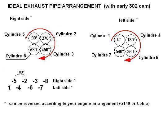

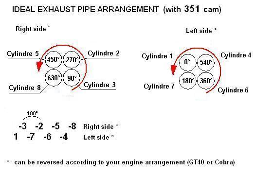

Originally Posted by Pat
Interesting thread, thanks!
Since it has strayed somewhat, I don't feel bad asking a question that isn't related to dry sumping .....
My CAV has a 302 crossover exhaust but the engine came with a cam that has the 351 firing order.
2 questions:
1. What effect will this have on power output?
2. Will this make it difficult to tune a set of IDA's?
Pat
Hi Pat
As you say, interesting subject! Thanks Russ for the right link where we can find some interesting point of view:
Originally Posted by JCoop
Correct me if I'm wrong but the 351 based motors do not have the same firing order as the 289/302/460; which I'm told the bundle of snakes 180degree exhaust system was designed for. It wouldn't sound the same and the pulse-extractor effect wouldn't apply, I think. My 302 w/Webers sounds wildly awesome as compared to a friend's GTD w/ 351 @ 4500 RPMs.
Originally Posted by Sandy
I had asked the firing order question a long while ago too (302 vs 351) and I think it does not matter. I think the question came up as I run 351 firing order (in a 331) in the mustang and most of the roller cams that I had were that way as well.
1-3-7-2-6-5-4-8 Late 5 Oh's, and 351
1-5-4-2-6-3-7-8 Early SBF's
(I hope I got them right...)
I guess the easiest way is to look at the pipes and collectors and map to the above and see if it seems like it would change the effect of the bundle o' snake. My guess not really. My mustang has a Dr. Gas X Pipe on it (regular car headers) and it is very Gt-40'sh sounding.
[edited]
If this helps, it looks like the headers on my engine are mapped like this (hard to tell from the pics but looks like this) -
Left Right
8 - 2 7 - 4 Top
| x | | x |
5 - 3 6 - 1 Bottom
Looking at the rear of the collectors from the back of the car. The number is cylinder of engine it connects to.
Sandy
It is a common agreement that exhaust pipes must be grouped by 180°. However, in order to have the best "pulse-extractor effect " as mentioned by JCoop, it is necessary to have a circular pipe arrangement according to the order. It means that for a SBF engine with a 302 camshaft the ideal merge collector arrangement should be modified as follow: (I refer to the nice data from Sandy)
Left________ Right
5 - 2 ......... 6 - 4 Top
| x | ..........| x |
8 - 3 ..........7 - 1 Bottom
You note that with this new arrangement the circular order is clockwise at the left side and anti clockwise at the right side.
With a 351 camshaft the ideal merge collector arrangement will be as follow:
Left________ Right
| x | ..........| x |
This data is the same like the 302. However, in this case both circular orders will be in opposite to the 302.
To conclude, we note first that the Sandy's merge collectors have not a circular order for a 302 cam. In second, I agree with Russ, whatever the camshaft that you use (302 or 351), it doesn't affect power nor Weber tuning, except if your circular arrangement is like Sandy. In this case, we note that it could be correct at one side (left) and incorrect at the second (right) when you use a 351 camshaft. That means you will have a different pulse-extractor effect at one side that will affect power... and Weber tuning
Hope to be clear despite my language problem

Damn, I'm going to be down some hp , but not to worry I don't have webers so that part is ok!
[edited]
Now that I think of it, why do the have to fire in a circular order, does that help? Will the distance of the diagnals (1.4x center to center worse case) make a huge difference, especially in the collector (or merg collector) area?
Sandy
[edited]
Sandy
By firing or pulsing in a circular manner the signal is the same for all cylinders, the merge collector is suited to the even 180deg pulse, while the larger volume collector typical of most conventional non crossover exhausts helps accomodate the uneven pulse's. You will also find that with the 180deg system you can use a smaller dia tailpipe than you will require with the conventional type. (270/180/90/180) pulse interval's.
Jac Mac
[edited]
Sandy
Sandy, when you try to empty quickly a bottle of water, you give a circular movement at the bottle that will create a mini wirlpool inside to accelerate the empty operation. Exhaust pipe circular arrangement follows this basic principle. Whatever your induction system (carbs or injection) this design is in relation with your camshaft characteristics and your induction tuning. However, don't worry, there is not a large difference between all different arrangements. My purpose was only to indicate the best theorical way
As a small sketch is better than thousand words (mainly for me )
please have a look below
Name:	ordre des tubes 302.JPG
ID:	16156  Click image for larger version
Name:	ordre des tubes 351.JPG
nanard289 is offline

Re: What block preparation is required for dry sumping a SBF?
Jac Mac
When exhaust gas are going in the pipe, they are pushing in front but also they are pulling at the rear side (creation of vaccum area). This phenomena allows to open the inlet valve before the TDC despite the piston is going up to initiate the inlet gas movement. As better is the "extraction effect" as the inlet valve opening angle before TDC can be increased to improve the filling phase duration. Conjonction of the successive pulse can be organized to obtain a "resonator effect". This effect can be modified according to the different possible combinations. You understand that in order to take some advantages of the exhaust pipe circular arrangement it is necessary to spend a lot of test bench operations to find the best camshaft adjustment (thanks the different key ways in the distribution sprocket) that will induce also carb (or injection) tunning. I have also to specify that some benefits can be expected only for high rev engines
