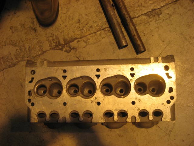

Those flow numbers you quoted were from me. They were indeed from a completely
stock set of heads, as purchased from Gurney. I also believe they were only
partially finished machined. That step I mentioned looks like a real flow
killer. With that removed and a good bowl porting and valve job, those heads
should do much better. I wouldn't be surprised to see them as good as the
majority of modern Windsor heads but that remains to be seen.

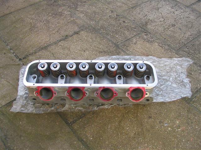

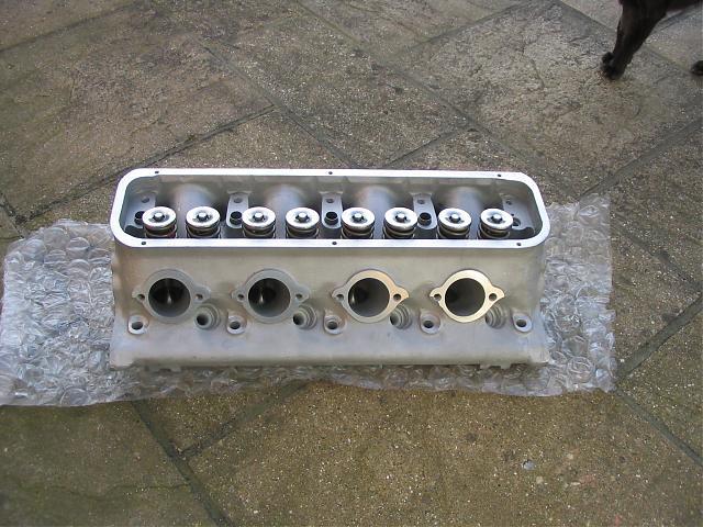

Detomaso also had a version of the the Weslake heads prototyped. Some
pictures of the Detomaso heads, along with pictures of the MK-IV heads
we flow tested, can be seen on my website at:
http://www.bacomatic.org/gallery/album18
Notice the modern chamber shape of the Gurney-Weslake heads, along with
the intake runner optimized for independent runner manifolding. BTW, my
buddy Bill had Harland Sharp prototype a set of roller rockers for his
Gurney-Weslake heads. The G-W's have a shaft mounted rockers with
different intake and exhaust rockers.

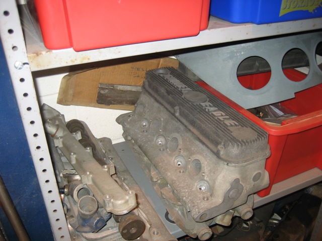

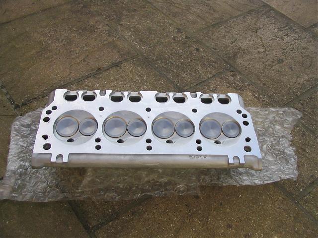

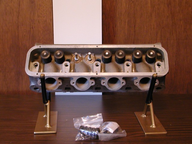

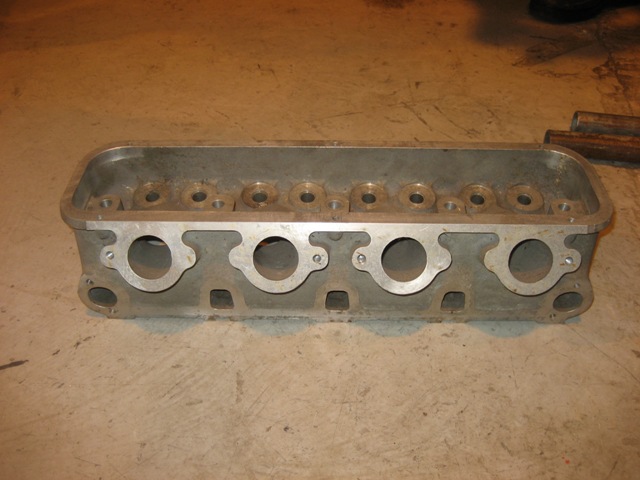

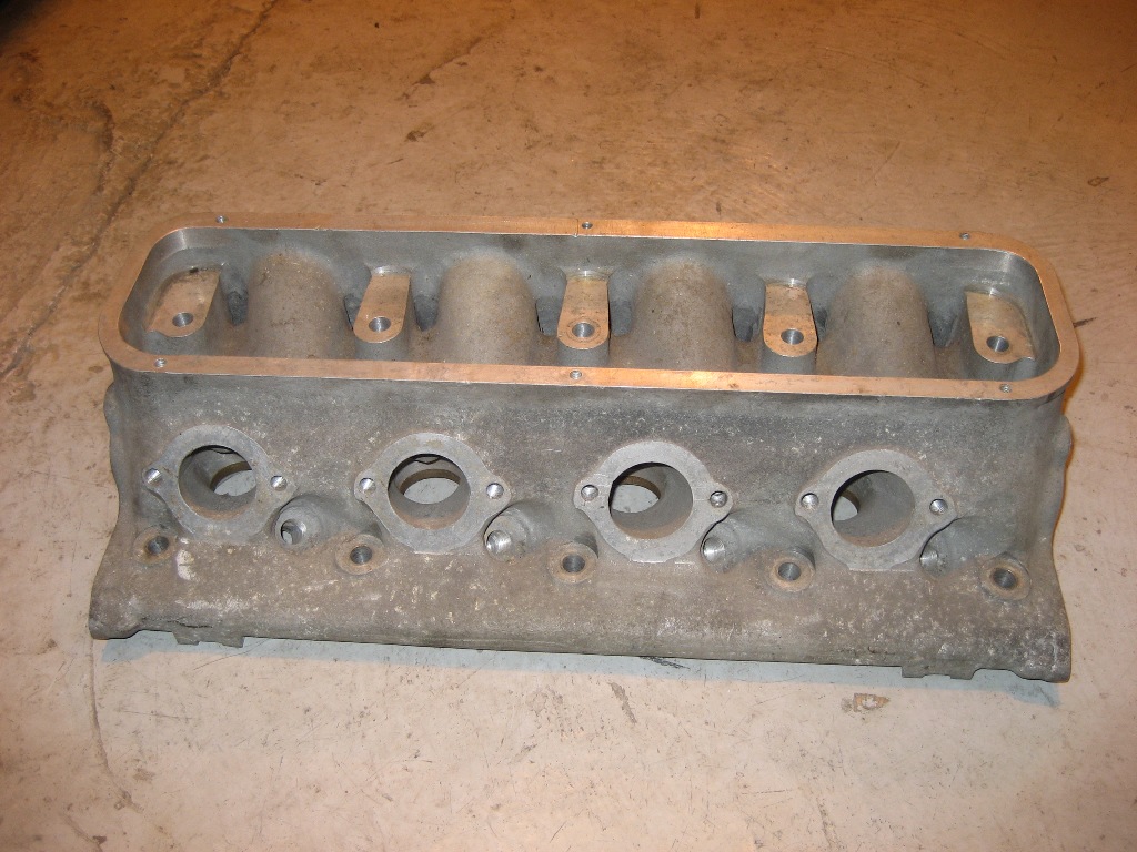

Here are a few pics of GW bits which may be of interest.

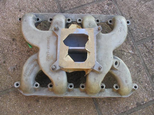

This may be a bit rare - a Holley manifold for GW.
