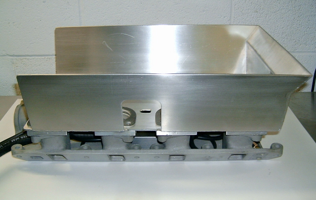

Hi Guys,
We'be been working away at the Webers for quite some time know. Nothing looks or sounds like them and they can be tuned, if you're patient and have good drugs LOL.
Anyways, most of the Weber V8 kits available today have the carbs arranged as per Cobra application with the fuel lines running the perimeter of the carbs. The original GT40 manifolds had the carbs arranged so the fuel line terminated up the middle. This also meant the throttles pulled together rather than opposed so there is no bellcrank in the middle of the manifold. Little things but...
Ray Mara asked me to modify his RaceTep setup with a vacuum chamber for the power brakes and vacuum advance on his CAV. Well one thing led to another and he ended up with the vacuum, one bank of carbs rotated, new throttle pull setup, heat shield and backfire plate, wow...
So this is how it turned out. The first one took a pile of hours, however if you'd like your existing setup modified or are considering a complete 48IDA setup for your car please give me a call, we can do the whole deal. Note this can be a forward, center or backward pull for the throttle cable.

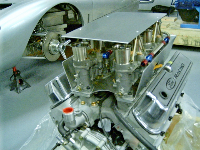

Another pic...

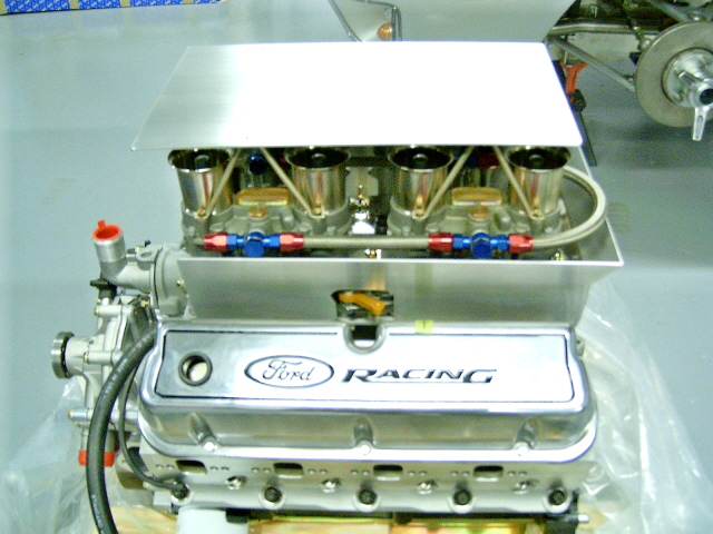

Another pic..

Ian,
I hate to rain on your parade but what you have done creat's a situation where at any throttle position other than wide open one bank has the flow biased to the floor of the intake runner while the other bank favour's the roof or top of the runner. The people who made the manifold went to a lot of trouble to do it right.

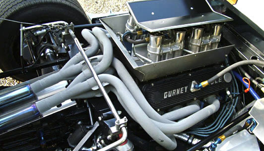

Hi Ian & Bryan, I know Russ is busy notching his chassis for the extra opposite lock tyre clearance he is going to need so I wont greet him!
Back to the discussion, any test to verify a difference would be best done with a full 8cyl EGT setup and check under part throttle load only- full throttle wont prove anything. If there is a gain to be made here it will be in fuel economy and driveability under road conditons at typical highway speeds.
The GT40 seem's to have it's webers all facing to one side as Ian has mounted his but the Cobra and Daytona Coupe cars have theirs mounted with them facing their respective cyl banks. I assume Shelby supplied the Cobra manifolds which raise's the Question -Did the GT40's prepped by Shelby have his manifolds. Brian I reckon the GT guys were just busy enough dealing with all the other problems sorting these cars without looking for problems of this sort. Thing's like keeping all 4 wheels on the ground and all the gear's in the transmission etc would be paramount. Which makes me wonder about your" If it was good enough for them, its good enough for me." If you copy someone that has done it wrong you seem to get slower, not faster. Would it not be better to look at something and say " yes I can improve on that"
To put it in a nutshell, you are asking one bank of cylinders to drink from the far side of the cup.

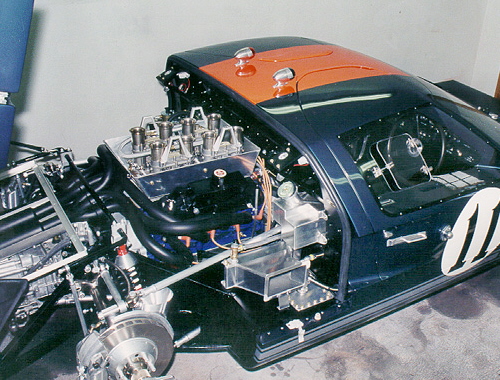

It's probably best to have some hard data before poohooing a part. I suppose Harry Weslake got it wrong too when he did the now infamous heads for Dan Gurney. I your analogy an engine with Gurney Weslake heads would have a power imbalance from the left side of the block to to right. Tuning wouldn't be fun either and cylinder pressure differences would be hard on cranks and blocks.
As stated before, I can see where your coming from with this comment. It just seems more theoretical than actual especially with no documentation to say the carbs back to back works better than pulling together.
I'm not here to split hairs or defend somebody elses design. There are many many variables in induction system design and manufacture that effect performance and you may hit on one, then again maybe not. Only the dyno knows for sure and given how vocal the Webers are when not happy the point could be proven and quantified either way.
To each his own, we do the heat shield and vacuum to suit both carb layouts. That heat shield drops 50 degrees F off the back pair of carbs!

Ian you have me mystified as well in relation to the GW heads as I am looking at a photo of all 3 variants of the two valve head. then you post a pic of the GW equipped car with the carbs fitted in what IMHO is the correct manner. Since the valves run in the same sequence as the basic windsor head what change's?
Keith , if you have been around holleys for a long time (like me) you will no doubt remember instances where you have had to stagger jet them to make up for differences in flow and port design etc.(BBChevs for example) along with all the other variables. With the two basic designs of IDA manifold we have one which mounts the carbs so that the airflow pattern thru them is the same on each bank of cylinders, while the other bias's flow to the bottom of the intake runner on one bank and the upper of the intake runner on the other bank. This condition will exist to some degree at any part throttle position. This all came about as Ian in making a very tidy job of the airbox heat sheild assy for his car went to a lot of trouble to turn his carbs around on one side of the manifold in order to have an "original" GT40 look.
