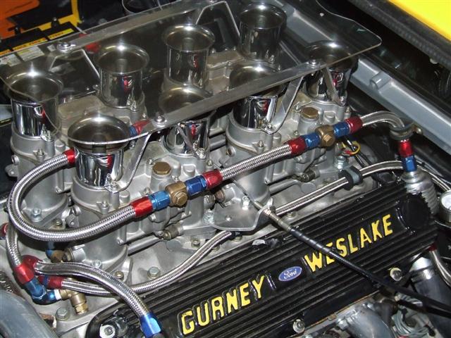

Finally, after a few snags and stupid things like loose heater hose clamps and loose fuel line fittings, finally buttoned up and test drove her. I'd say at least 15 HP more and more grunt in the low end. I have to work on the timing yet.
Ray

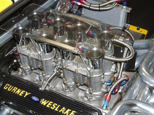

From the other side...

Spring returns
J Coop--
From your left side engine photo, it looks as though you've removed the return springs on your Webers and gone to an external tension spring on the side of your (very nice!) turkey pan.
If that's correct, would you comment on the advantage of doing it that way?
John

John, actually, I did not remove any of the stock springs. It was just that it was so soft at the pedal that I felt it needed additional tension. So, this works great and also serves as a good safety in addition to the MSD rev limiter. I plan to change to rod linkage eventually but I just started thinking about it...maybe a good winter project.

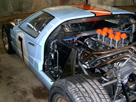

Here's our 347 EFI installation with the motor just about as low as you can go!
