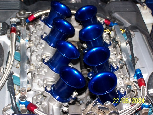

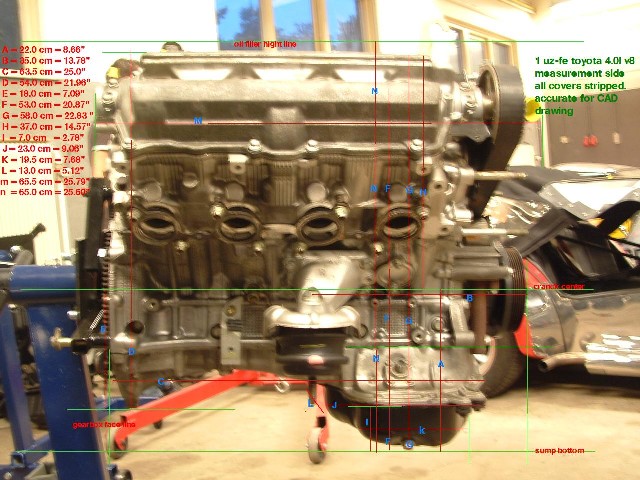

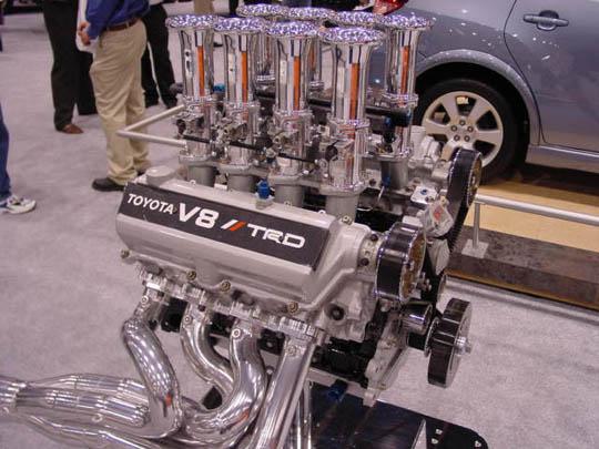

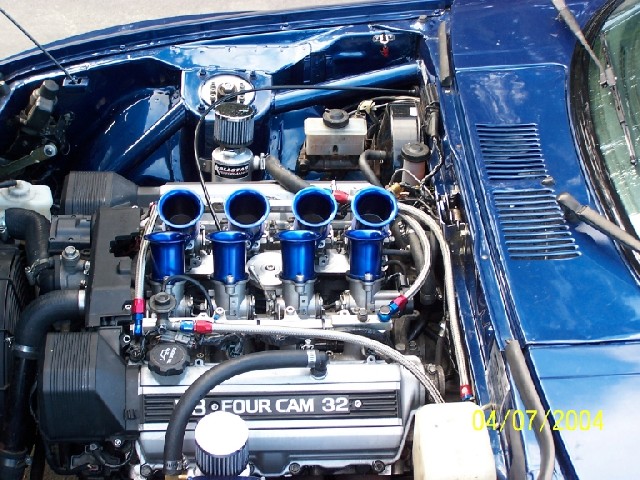

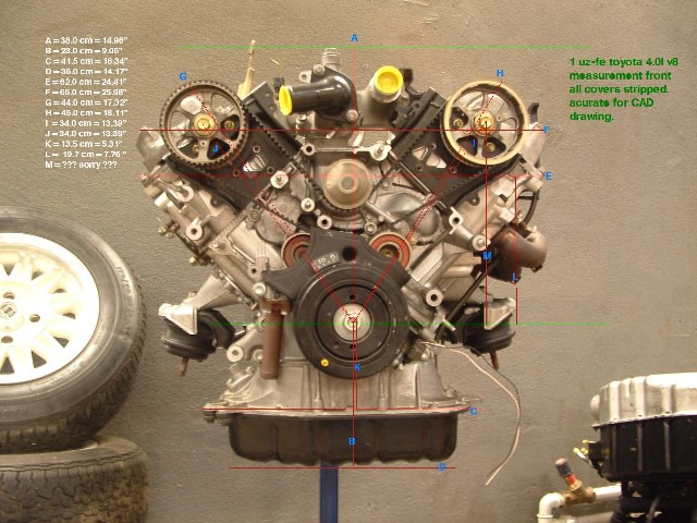

Engine weight is 200 to 210 kg, and you can think of it as a 650-700mm cube. More compact and lighter than the Ford 4.6 DOHC lump, but also lacking that additional 0.6 litre. Lots of good info about the 1UZ and its derivatives here: www.lextreme.com
Some on Lextreme are mixing & matching different components in an attempt to get the displacement up to 4.6 to 5.0 litres like we did in the 60's with the SBC's & SBF's. "It's deja vu all over again"
Here are the dimensional pics that were in the original thread, plus a few more....
