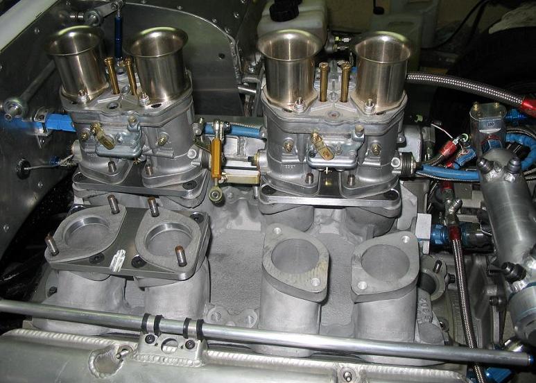

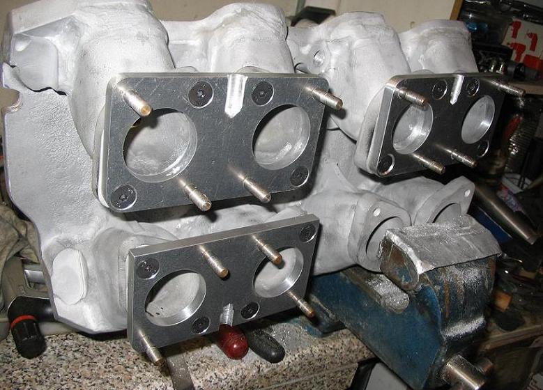

Weber carbs are a master piece of the Ford legend engines. So when I had planed to build a Cobra replica I had selected a Weber set. As I had Yates head cylinders, it was necessary to create a special inlet manifold to adapt it. Big job . I have selected the 48IDF type instead of the traditional 48IDA type for 2 reasons:
- there are designed with a shorter barrel center line that was more appropriated for Yates inlet ports
- There are thee last Weber evolution and there are more efficient at partial trottle opening (from time to time you need to be at partial opening )
