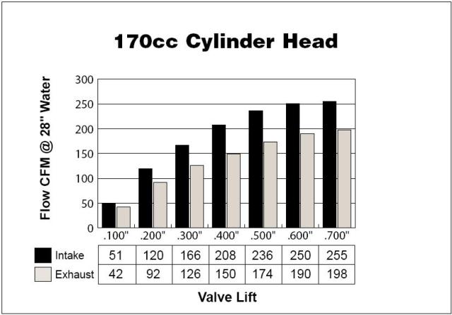

Can anyone tell me whether this is any good. Ta

Looks like a typical aftermarket alloy street head. The low end flow is lagging a bit compared to Trickflow TFS and AFR 185 heads. It would be a good head for a street motor. Capable of max HP of about 400-425.

I am not an engine person but the 170 cc seems it will be a lower compression engine than say a 164 cc set of heads? What CR will you get from these heads? I have found my 10.5 to 1 to be very reliable.

170cc is the intake runner volume not the chamber volume. Chamber volume should be around 60cc.

They don’t look like very good heads to me. I guess if you are getting a really good deal then they might be worth it, but if you are buying them new from Jegs then don’t bother. Jegs have them listed as $550 each. You would be better off going with the Edelbrock Performer RPM heads at $530 each or spend a little more money and get the Victor JR heads for $630
Here is a link to the flow chart for all of the Edelbrock heads…
http://www.edelbrock.com/automotive_.../flow_data.pdf
The part # for the Performer RPM is #60259 and the Victor JR is #77189 you can see that both will out flow the Jeg heads the (Victor jr by a lot). So either save some money and make more power with the RPMs, or spend a little more and make a lot more power with the JRs.
