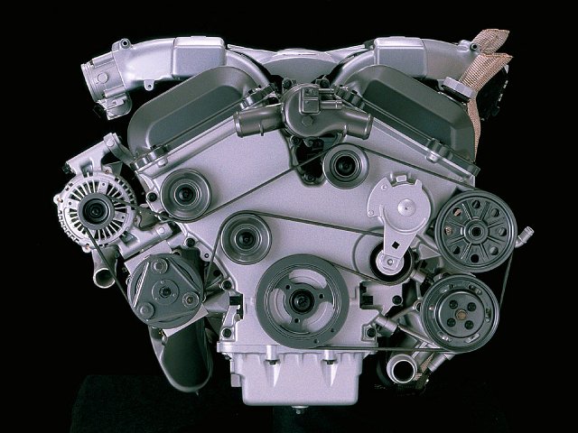

Here is a photo of the DB7 V12, which dimensions do you need?
Sandy

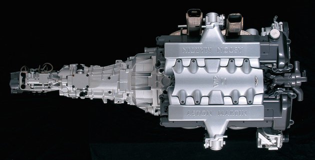

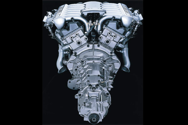

found these photos........
if you can get a reference dimension you can scale it and measure.....

Here are some very rough sizes, and use with a grain or two of salt -
Front to back is about 33" (length). This was measured from the top of the motor (front to back of heads). The front is pretty flat except for the upper radiator hose assembly (You can see this in Doc's photo's). That is out a couple of inches beyond the 33". Did not also see the offset for the bellhousing (how far off the back) just can't easily see it.
The width of the top of the engine is 29" from Flange to flange of the intakes (where the Throttle bodies bolt to on the sides of the intake).
Add another 6-7" or so inches to the total width (from throttle body flange) for throttle bodies and looks like the exhaust is about tucked in the same.
This was measured from a DB7GT, is does not have drive by wire, and the newer cars have different intakes it seems. This was measured all from the top of the motor and is very rough, I don't know what the weight of depth of the engine.
BTW I saw one on ebay a few months back from a DB7 with tiptronic as I recall was around 10k for motor. Was in the UK and said would ship to the US...
HTH
Sandy
