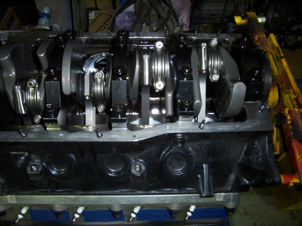

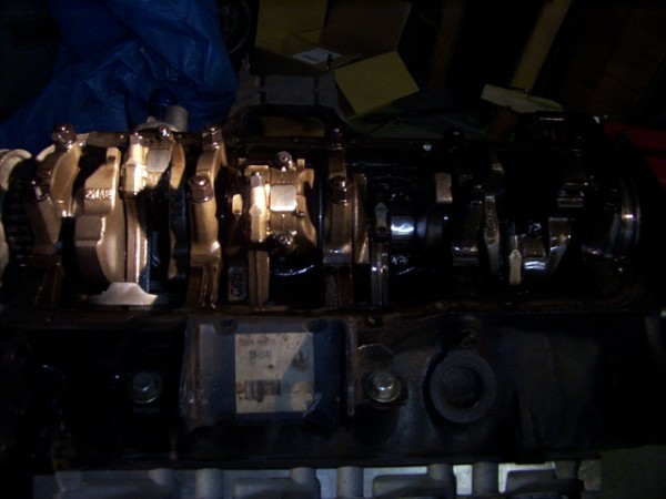

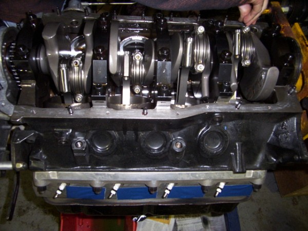

Had the sumps off both my old and new motors yesterday. See if you can spot which is which. Very nice bottom end on the new motor. All internally balanced and I'll be able to rev to 7000 rpm no problem with all that steel around.
Ross

Looks very nice, crank looks well worked as well. Now you should have no excuse for the Sniffin' Porsche Exhaust

Looks good, Ross. Have you considered using threaded caps in the casting plugs to give the block that extra little bit of strength that it might need at 7,000 rpm?

Hi Ross, I hope thats a double row timing chain & the other row is being blocked off from view by the front main cap. Also are you going to rebalance your old flywheel to zero to suit this combo. Apart fom that everything looks good from here.

No Mark I have to fit the Motor in as is. It has run in the Daytona Cobra for a couple of race seasons with no problem. Jac Mac that certainly is a double row chain at the front.I had flat batteries in the camera and the flash didn't work too well. My flywheel is a Mcleod aluminium one and has the 50oz balance weight that was necessary for the old crank. I will obviously take the weight out, but would you recommend I have it rebalanced? Great to have expert engine people around with no financial or vested overservicing interest.

I totally agree with you on the don't assume anything Jac Mac. The flywheels will be checked. The machine shop I use is well known in the V8 Supercar circle so their work is of a high standard. I had to notch the side of my sump to clear the 4 bolt mains caps but it's on and the motor is sitting in position for fit checks. It's got a long nose water pump and alt on the opposite side to
my original but I'm going to put clearance lumps in the bulkhead panel. Maintaining the original pulleys for water pump, alt and oil pump will save a lot of time and is also a proven working unit.
