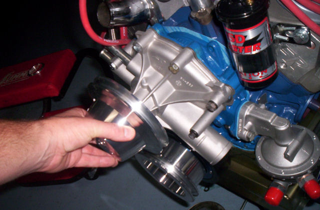

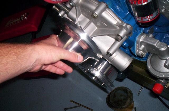

I've been waiting forever for parts for the front dress on this motor. Pump, then fuel cams,then tapping the fuel pump cam, fixing the old cover, lots of things.
Waited three weeks for some billet pulleys from FMS that were supposed to fit, but, they don't. The water pump pulley would need at least a 1" shim to get it out far enough to mesh with the crank pulley. What is the point of having a short pump if you are going to shim the pulley out to where a regular pump would be? And, naturally, the crank pulley is also much longer than it needs to be.
And, this pulley set was supposed to work with the short standard rotation pump. Anyone using this pump, short pump from FMS, with v-groove pulley? What pulley set did you use to get it to work?

Alright, figured this issue out. I have pulley kit 8509C and this is for the long pump. And, according to the FMS catalog it'd take a 1.5" spacer to make it fit.
I need 8509-Q, a single groove set for this pump. 8509-Q has been, according to Jegs and Summitt, discontinued. Yay.
