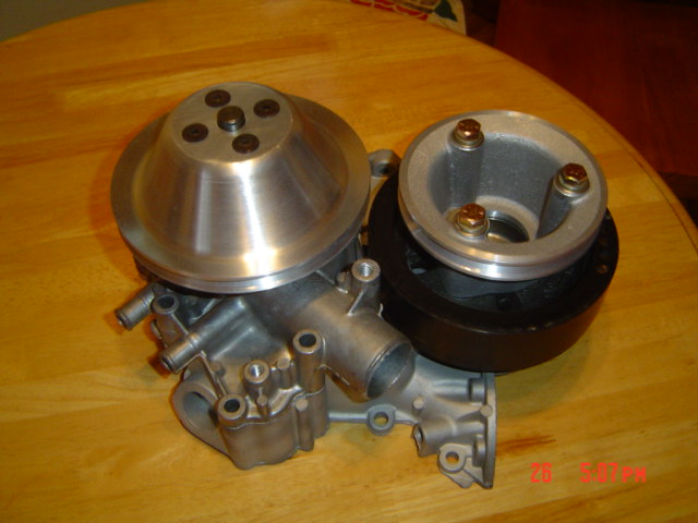

Had to make mine
Ron,
I'm using the short pump. Because the engine is built on a race block it has an external oil pump and uses serpentine (flat) belts. Guess where that left me ... absolutely nothing could be bought. So I made the entire front end setup. Bought 7075 plate and bar on e-bay and milled and turned all of the parts including two idlers. We'll see how this works when it's fired someday ;>)
http://www.mstarling.com/Album/front_equip_S4_2vs.jpg

Hey Mike, that looks really nice! I'm sure it willl work well. How is the rest of the car coming along? I hope you are making some progress and will get her on the road.
I ended up turning down a spacer for mine - about 0.590" to get it all lined up right, but, making the spacer was simple and far less time consuming than doing a new crank and water pump pulley. There are so many variations of front cover, pump, damper, and pulley sets for a SB Ford it isn't even funny. That is one area that I think the SB Chevy motor had a distinct advantage - front dress. I've not worked on a lot of SB Chevys but the few I have worked on seemed to be the same, although spread apart in years and application. Heck, the SB Ford has changes in mid-year for the same application sometimes.
There definitely is a market for someone to produce a timing cover, with provision for fuel pump, that uses a reverse rotation pump, short style, and couple it with a off the shelf pulley set and spacer with a commonly available alternator and sell it as a set. I don't know how many times I've played this game with a SB Ford, this is just the first time with a old style cover.

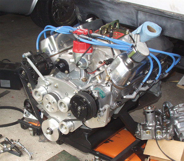

I know this is an old thread, but I was messing about a bit on the WWW and ran across this company, which claims to make pretty complete front dress systems for long or short pump SBF motors with just an alternator, an alternator and an A/C compressor, an alternator and a power steering pump, or an alternator and power steering pump and A/C compressor. The ones for A/C are kind of costly, but the price does include an ultra small polished Sanden A/C compressor with hard lines. Here's a link in case anyone else runs up against this problem: Small Block Ford Kits
Doug

OOPS--in my enthusiasm to share this source, I guess I forgot about that one "little" complication. I'm sure you are right about the electric fuel pump issue, Ron. For someone like me, who is lacking in fabrication skills, the complete nature of this system would be a big draw.
I guess the reason the site interested me was b/c of the issue of A/C--I wonder if it would be a good way to get the A/C compressor into the small engine bay of these 40 replicas. I know I'll need A/C in mine (when that glorious day comes!). I've not heard of many of us using power steering.

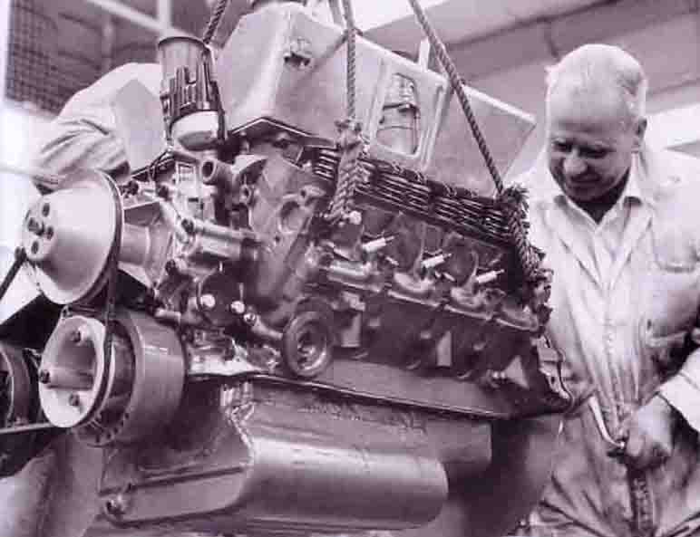

The picture on my last post shows my attempt to replicate the front of the 289 engine as used on the gt40’s in the early sixties, I have also made the alternator bracket and a friend made the alternator pulley, no ac provision on the MKI race cars that I know of but I could be wrong.
