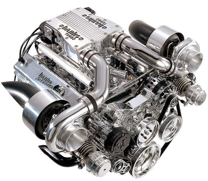

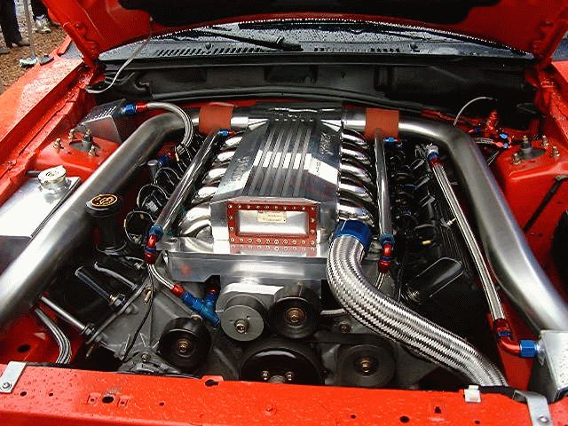

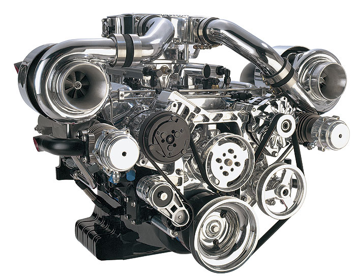

Rep Power: 5  | IMO, turbos are tough to make visually appealing. I own both a twin turbo car and a single turbo car, and the turbos just look like they've been "hung" on there, even though one is an OEM setup.
Gale Banks probably does the best job of making a twin turbo V8 look visually appealing and "engineered" instead of just "hung on".
Below the Gale Banks TT photos is the nicest blower setup I've ever seen, on a one-off V10 Mustang project. IMO, that competes very well with a set of Webers or ITB's for visual appeal.
John |

Rep Power: 3  | That looks fantastic and everything is in it's place. Do you know what the cost is ? What is the cu. in and the hp numbers ? I'll look at his site. |

Rep Power: 5  | Have a look on his website - Banks has a long history with Chevy, but builds engines and "kits" for most domestic lumps these days. That particular motor was a 6.0l built with a Dart block and lots of other goodies, and produced somewhere around 1100 BHP @ 6800 with 20psi of boost.
You'd be hard pressed to find a transaxle that could handle the output of that thing, and as others have said, for a GT40, 350-450 BHP is apparently plenty of power anyway. After all, it's really a 2000 lb racecar that's also street legal, not a 3500 lb Mustang, trying to be a racecar.
John |
